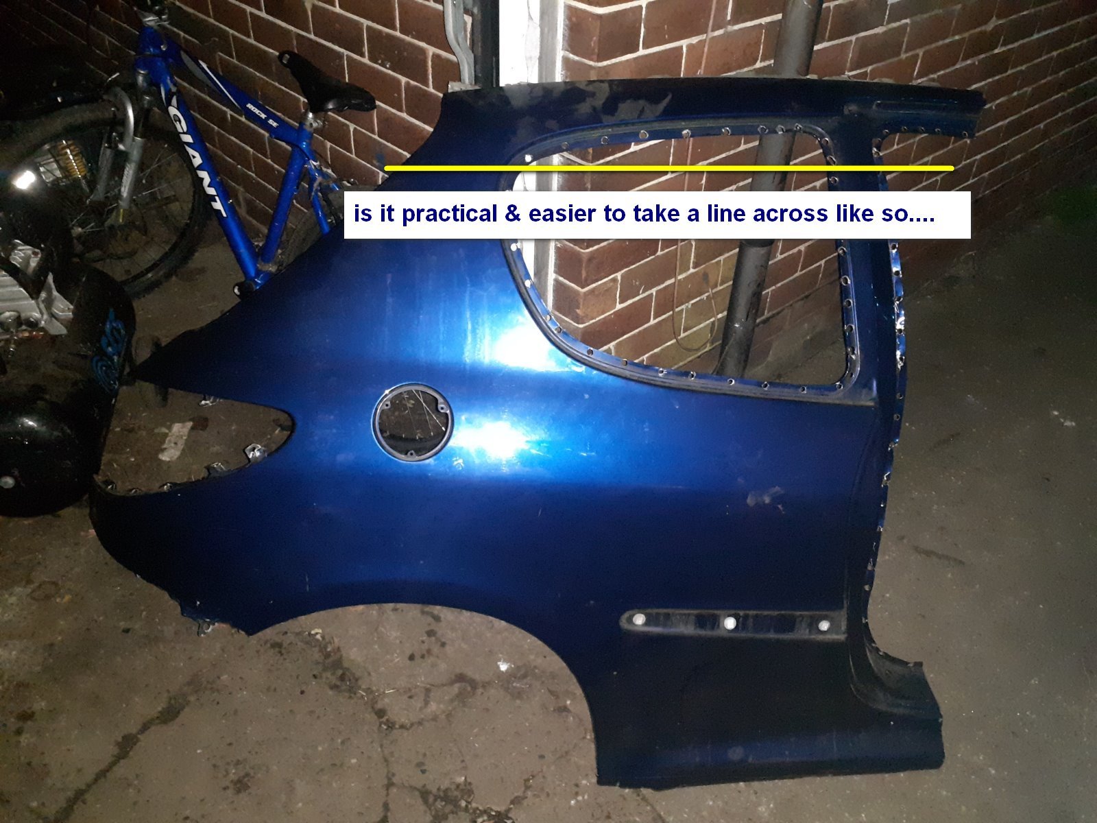

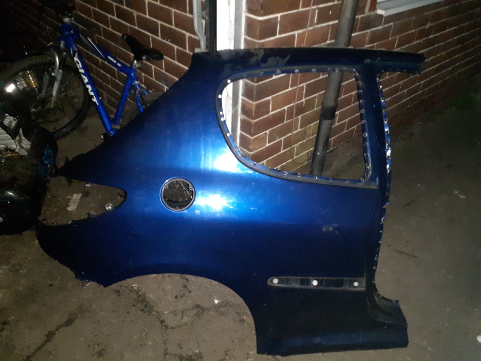

sounds like a good plan to me. I've yet to try the 'only going through one skin' idea with a spot weld remover, but that day's probably coming soon.
Oddly enough I've been metal-working today also; on a much smaller scale, continuing with the 'Adaptor bracket' for the Coolant Header Tank, its a time-consuming process with templating, cleaning, cutting, marking, bending, etc, etc..
I saw a clever way of making butt-welded panels just right somewhere; it basically involved placing the new panel carefully over the old and slicing through both simultaneously with a 1mm slitting disc.

just thought, be easy to demonstrate my idea.
Puxa

I saw that somewhere myself & might try that, although not sure if I can line it up well enough with the overlap. Hope your day was as productive as mine turned out, wasn't really expecting to have the quarter off today much less have the tailgate aperture/hinges un-tweeked!
I did think about doing like you've suggested but that introduces another, much longer, section that I have to get perfectly smooth. That was the main reason behind my decision to go to the roofline, so I can hide the join as much as possible.
Can you tell I don't trust my bodywork skills?
Also, I think there was a bit of a ripple in the panel near the top.

No, I think you did a lot better than I did, but I was satisfied with my day too. I think you trust your bodywork sills about the same as I trust mine!ekjdm14 wrote: 04 Jan 2020, 18:36...hope your day was as productive as mine turned out...
