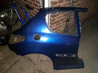

Finally managed to get a couple of photos of some progress this evening, knocked off just after dark and have now got the replacement quarter panel, lamp recess & inner arch support off the donor car. Fortunately most of the panel bonding/seam sealer had gone quite brittle & with the spot welds drilled and slices through the sill and door shut it came off reasonably easily with just a couple of small marks where the bonding was still sticky. Should be a bit quicker removing the crocked panel as I don't have to worry about ruining it as it's already mashed!

Cracking job there, I know from working at Toyota in the weld shop how hard that is. Will you puddle weld the panel back on? If you get blow holes use a piece of copper at the the back.
Impressed.
Impressed.

Yes it was quite "interesting" to remove the panel without trying to damage it. The only real pain was where the quarter is sandwiched at the roofline between the roof skin and the bodyshell proper, that'll be tricky to get without mauling the roof on the '06 car (I just sliced a convenient hole in the donor's roof).
I'll be plug welding it back on at the original spot weld holes, thanks for the tip about copper behind if I blow through, I can see me needing that one lol my skills are a bit rusty. (when I remove the damaged panel I'm planning to slice it off with the grinder and then obliterate the flange left behind with flap disc to leave as much "meat" as possible to reattach). Where the join will be visible above and below the door I'm contemplating either joggling and lap jointing or trying to be flash and butt welding (possibly with a tacked on fishplate behind to help with blowing through). I have a feeling the roof/gutter line joint will have to be lap or butt jointed too with a section of the original panel left behind so I don't have to get into the roof at all. Obviously the roof skin seems to have been the final piece in the puzzle as far as factory shell assembly went, but at least that can be hidden by the gutter rail trim so the only bits I have to get "just so" are the couple of inches above the door and the sill below.
Will have to wait on funds now though as I need sikaflex, shutz, flux cored wire and a new welding helmet as my old one got smashed. Probably go with an auto-darkening one this time as that'll be so much easier. Probably be well into next week before I get as far as reattaching bits.

Good luck, I'm sure you know this but use a lot of mole grips and make sure there isn't an air gap between the panels when you puddle weld, that's a hole for sure. Also don't weld in a line, split the puddles up into equal distances, like doing a head gasket.

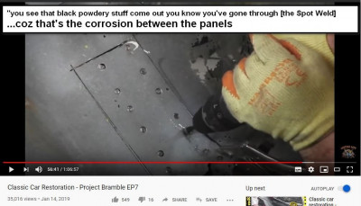

That’s a big old bit of welding there ekjdm, will watch with interest.
If you’ve not got any copper as a Heat-Sink, which is a damn useful tool to have; Aluminium works just the same and is potentially cheaper. Mine originated from a domestic Shower cubicle and I’ve plenty, so if you want some, you’re welcome.

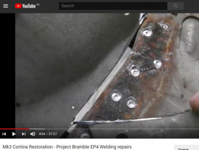

Something I hadn’t realised until recently regarding drilling Spot Welds, which will be more applicable on the repair car, is that you don’t have to go all the way through. If you also hadn’t realised, these Screenshots I’d saved for myself in the course of watching Pete C on Youtube "Cortina City" will potentially be useful. I’ve always used a cheap Spot Weld Drill Bit from eBay (about £1.50 each IIRC) and found it to be fine; with a drop of cheap 20W-50 to keep it cool.
Do you have a joggling tool? If you don’t, I suggest you don’t waste your money buying one; I was deeply unimpressed with mine and promptly sold it. I’d favour the fish-plate method, which can be temporarily bolted or riveted in position; I like to use bolts rather than rivets, coz you can make the bolt captive and pull em tight (the bolt remains in the panel forever, just grind the nut off flush when you're done).

Yeh I'd bought a couple of cheap cobalt-tipped spot weld drills in anticipation of the job, they work really well. I wasn't bothered about going all the way through on the parts car as it's not going back together but I am being a bit more subtle with the one to be repaired.

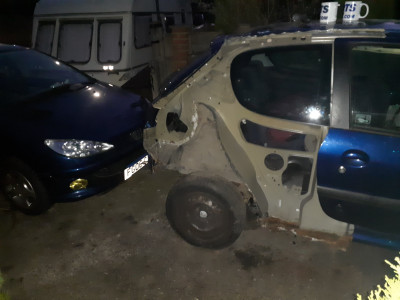

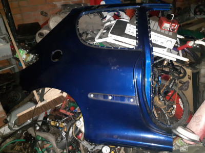

Got a bit done earlier (just knocked off now), stripped the interior back and did a rough cut of the damaged panel to get the bulk out of the way & so far have removed the spot welds from the side window surround, lamp housing, back of the "C-pillar" and strengthening panel, only went right through a couple of times by accident! Then moved onto reshaping the tailgate aperture and straightening the hinges so it now shuts nicely and lines up well. Think I will butt weld the joins with a fish plate as joggling would be impractical given the curvature anyway now I think about it. Can't do a lot more until welding supplies come in but will try and have the car and panels ready to be mated together when it all arrives.
Have to say, it's not as godawful bad as I had imagined so far (definitely not a body man!!!) and it's just like a big 3D jigsaw in the main. I'm thinking with the roof join, I'll leave a flange of the original quarter sticking up in the gutter trim area & kinda "hook" the replacement over that & plug weld there so I don't have to disturb the join between roof skin and main shell. Anyway, time for dinner I'm starving!

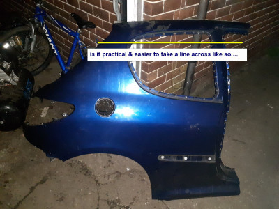

sounds like a good plan to me. I've yet to try the 'only going through one skin' idea with a spot weld remover, but that day's probably coming soon.
Oddly enough I've been metal-working today also; on a much smaller scale, continuing with the 'Adaptor bracket' for the Coolant Header Tank, its a time-consuming process with templating, cleaning, cutting, marking, bending, etc, etc..
I saw a clever way of making butt-welded panels just right somewhere; it basically involved placing the new panel carefully over the old and slicing through both simultaneously with a 1mm slitting disc.

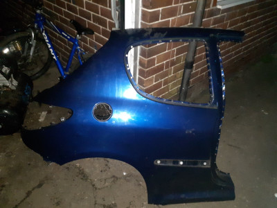

just thought, be easy to demonstrate my idea.

I saw that somewhere myself & might try that, although not sure if I can line it up well enough with the overlap. Hope your day was as productive as mine turned out, wasn't really expecting to have the quarter off today much less have the tailgate aperture/hinges un-tweeked!
I did think about doing like you've suggested but that introduces another, much longer, section that I have to get perfectly smooth. That was the main reason behind my decision to go to the roofline, so I can hide the join as much as possible.
Can you tell I don't trust my bodywork skills?
Also, I think there was a bit of a ripple in the panel near the top.

No, I think you did a lot better than I did, but I was satisfied with my day too. I think you trust your bodywork sills about the same as I trust mine!ekjdm14 wrote: 04 Jan 2020, 18:36...hope your day was as productive as mine turned out...
