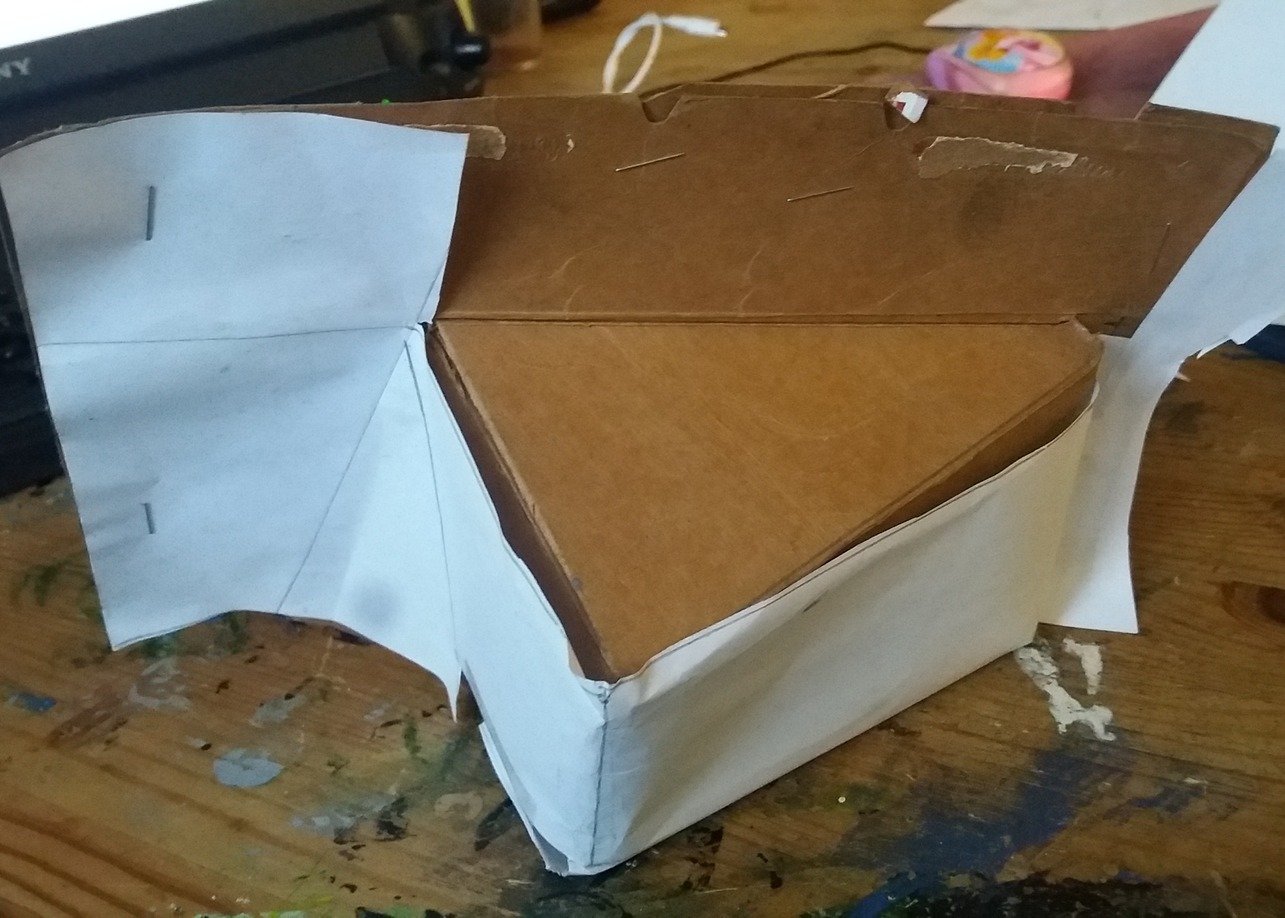

further small question that somebody's probably got an answer to....
Roughly how much metal should I allow for 'loss in the curvature of a a corner', when transferring a paper template to steel?
Obviously I'm gonna get a sharper corner with a piece of paper than I will with a bit of 0.9mm Sheet Steel, think that's 21 Gauge
My first template for the Header tank is a mile out, so I've started again as pictured, and I'm keen not to do it a third time...
...I'm thinking that if I allow an extra 3mm to 5mm (1/8" to not quite a 1/4") for each bend that'll be about right?
Or maybe someone's got a suggestion how to work this out?

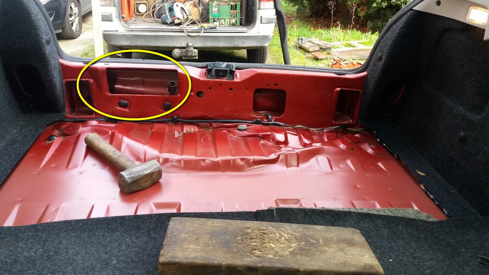

when I haven't been looking at cars, work has commenced on beating the boot floor of the 206 back into shape; I was pleased to find damage was limited to the rear-most panel, behind the cross-member and that none of the structural members are damaged. Initial thoughts were to plug-weld a new one on, but I'm going to attempt to straight it first using Blocks of Wood and lengths of stud 'squeezed together', the lower block with a channel cut in its middle for the stud to move as the Boot Floor moves back to flat-ness. I've not made these yet, but hope to do so in the next few days.
....a wee 'PS' about this. Is this yellow circled area damage, or is that panel supposed to be like that?

On the 206 boot floor, I think the bit circled does have a crease in it. So far as I recall that bit was pretty flat inside the boxed area, it's where I stash bulbs/fuses and a can or tyre foam. Good move getting it as straight as poss beforehand even if you do plan to replace, that's how the pros do it, get everything where it should be first so that the new panel lines up easier when you start cutting the wrinkly bits out.
