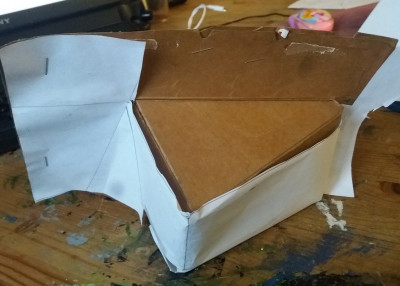

further small question that somebody's probably got an answer to....
Roughly how much metal should I allow for 'loss in the curvature of a a corner', when transferring a paper template to steel?
Obviously I'm gonna get a sharper corner with a piece of paper than I will with a bit of 0.9mm Sheet Steel, think that's 21 Gauge
My first template for the Header tank is a mile out, so I've started again as pictured, and I'm keen not to do it a third time...
...I'm thinking that if I allow an extra 3mm to 5mm (1/8" to not quite a 1/4") for each bend that'll be about right?
Or maybe someone's got a suggestion how to work this out?
