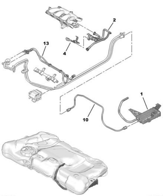

You will find that most THP petrol engines have a Canister Depollution Absorber (ESS Vapour Absorber) - item (1) below, but these are not used on PSA diesels - so code P1457 is relevant to HDi vehicles, but has nothing to do with the fuel vapour purge system as they don't have them. If you get this fault on a Diesel, you need to be looking closely at your particulate filter integrity and do not ignore the fault!
