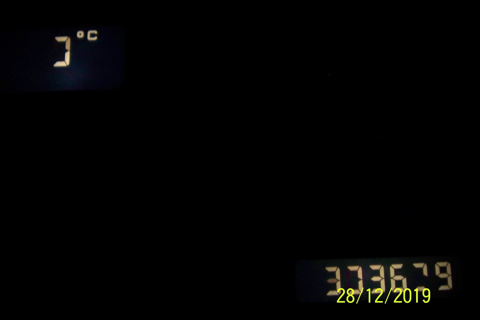

Seems like only two 'wires' to the actual counter. Each number is composed of the required number of the 8 lines required to make the no. 8. It's some of these lines that are not working, eg the mid horizontal line of 3 is missing.
My wife is in England with our 2nd car at the moment & I need transport. I'll have a good ferret next week after her return when any 'damage' I might do to the old Pug that might disable it will not be so important.

I've now taken the panel out again & cleaned, as best I can, the pins with a toothbrush & the plug sockets with contact cleaner sprayed in whilst working the plug in/out.
Nothing has changed & I still get some dodgy numbers !.
Bart Ebben, who supplied the 2nd hand piece, assure me it was Ok when tested & the Controle Tecnique guy has issued me with a new 'pass' valid for two years so unless any of you fine folk can suggest anything else I can do I'll have to be content with that. Thanks for all your help with this.

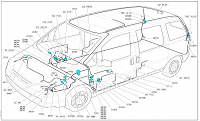

Ok, so having another look at the limited data in the diagrams - I think that the common link here is possibly the earth. If the unit is behaving the same as your old one, then it has to be a local wiring issue.
There is not greater detail given the age of the vehicle, but I have determined there is a common earth to part of the instrument cluster that displays the exterior temperature and the odometer. That being the case, I tracked down Earth MC40.
From the following diagram, you should be able to see that there are a bundle of earths (MC40, MC41, MC44 & MC55) that are terminated to an earthing point somewhere in the central area of the dash / bulkhead near the base of the windscreen. It's possible that the connection here may be the culprit due to poor contact / corrosion or condition of the wire at the mounting point.
It may be worth a bit of investigation (try checking from the engine side first) to see if you can find the earthing points. If the contact is poor, then it may be sufficient to create a poor circuit.

That looks to me to be more likely to be at the base of the A panel near the inner sill on the RH side. It's difficult to tell from the diagram but there may be another earth point in the mirror position on the LH side.GiveMeABreak wrote: 02 Jan 2020, 11:47From the following diagram, you should be able to see that there are a bundle of earths (MC40, MC41, MC44 & MC55) that are terminated to an earthing point somewhere in the central area of the dash / bulkhead near the base of the windscreen.

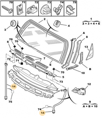

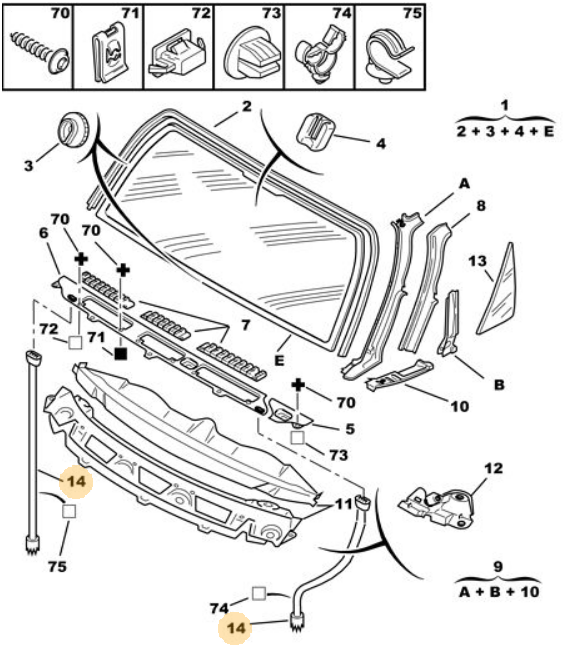

As for the water drains, check under the front wings - there is usually a drain flap that gets blocked up that allows water to flow out both sides to the road. Leaves and muck can get in under the wipers and air grilles, blocking the drains up.
Items (14) on the diagram show the pipes I am talking about. On the diagram, follow the dotted / dashed lines to see where the pipes connect to under the scuttle. These can easily get blocked. If you can first unblock the ends of the pipes under the arches, then get something non-sharp and work it through the pipes, whilst pouring water on the screen it should help rinse any debris through.

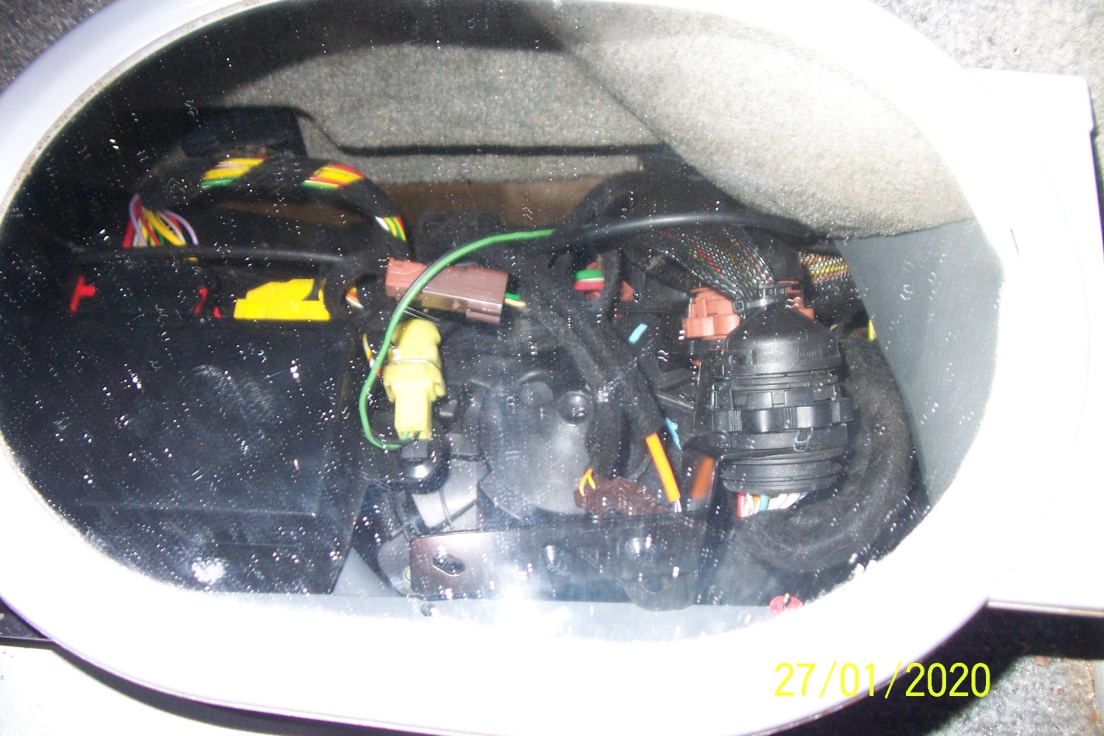

I've just had a 'half hearted' look to see if can see the fan & have unscrewed & folded down the 'felt' cover beneath the glove box.
Pouring with rain outside, gloomy in my barn & granted I haven't spent ages looking but my immediate reaction is "where's the fan?". Lots of wiring with large connectors blocking my admitted dodgy view but can't feel anything I think might be the fan.
I'm expecting the motor & fan spindle to be in the vertical axis & come out downwards.
Anybody (Marc?) know what I have to remove to get at the fan as without standing on my head I'm struggling. It would be nice to know what I'm looking for/at before I demolish too much or do me back in.

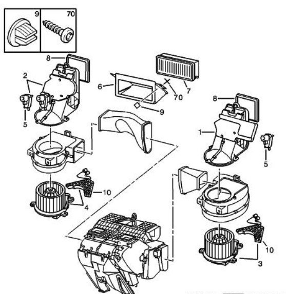

- x 6945
Re: faulty 'screens' on 806
Which one? You have 2 fans on this one on the left and one on the right:
- x 6945
Let me know left or right side (or both) and I'll probably get something (what little I have) on this tomorrow for you.

Thanks Marc. It's the right hand side which is the passenger side in my case.

I've just had another look using a mirror & can see the fan. Trouble is it's got a lot of wiring below it & what I assume is the computer to the left, looking forwards.
Seems like it might be doable if I can clear some space.
How do the large round connectors come apart as splitting these might give me enough room to wrigle the fan unit out assuming I can't replace the resistor in situ. rubbish photo taken through mirror
