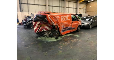

The RAC van features on the TV motorway programme, the driver said he'd parked it behind the broken down vehicle two car length back with the wheels facing off so that if it got bumped it would steer off the road
It was hit so hard that it flew in the air and landed on its side.

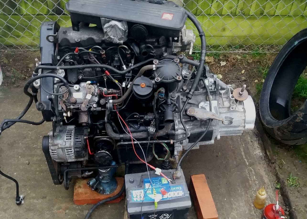

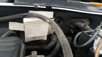

Getting Back on Topic....
some progress with the engine
PAS Pump and Alternator fitted with suitable Cast Iron mount (which could really do with a coat of paint), Aux Belt and Lollipop. These might come off yet, but I wanted primarily to ensure that I had small parts such as fixings 'readily to hand' when it comes to final fitting.
PAS Pump has a replacement 'feed' pipe as this will be lower down in the engine bay than it was previously with the AC & PAS set up
Also fitted is wiring for
Glowies
Stop Solenoid
Starter Solenoid Its not yet got a Fuel supply, but hopefully with a feed from a Gallon can and priming; it'll fire up.... I'll probably give it additional support from the Hoist too. It appears from turning it on the Starter that its inclined to 'fall forward' (ie onto the alternator, rather than onto the Inlet Manifold) hence the placement of the two bottle jacks.
...oops, only one at the time the pic was taken, there's a second under the Bell-Housing.
Glowies
Stop Solenoid

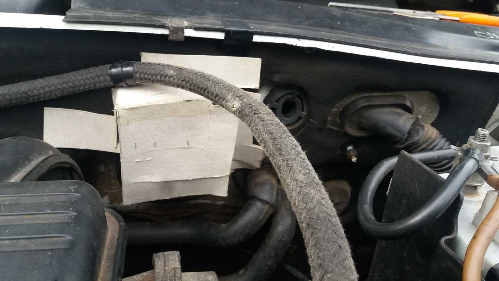

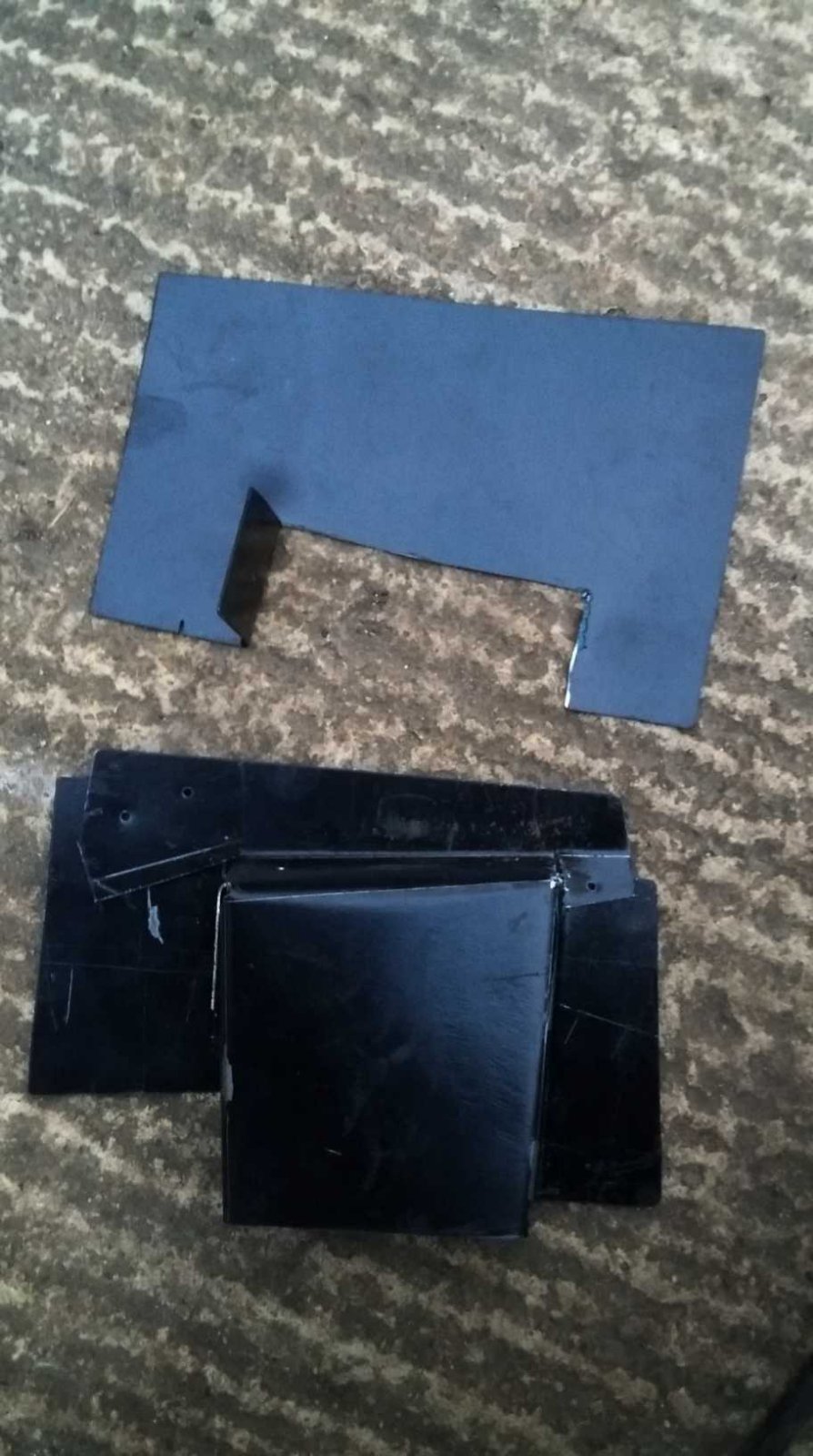

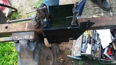

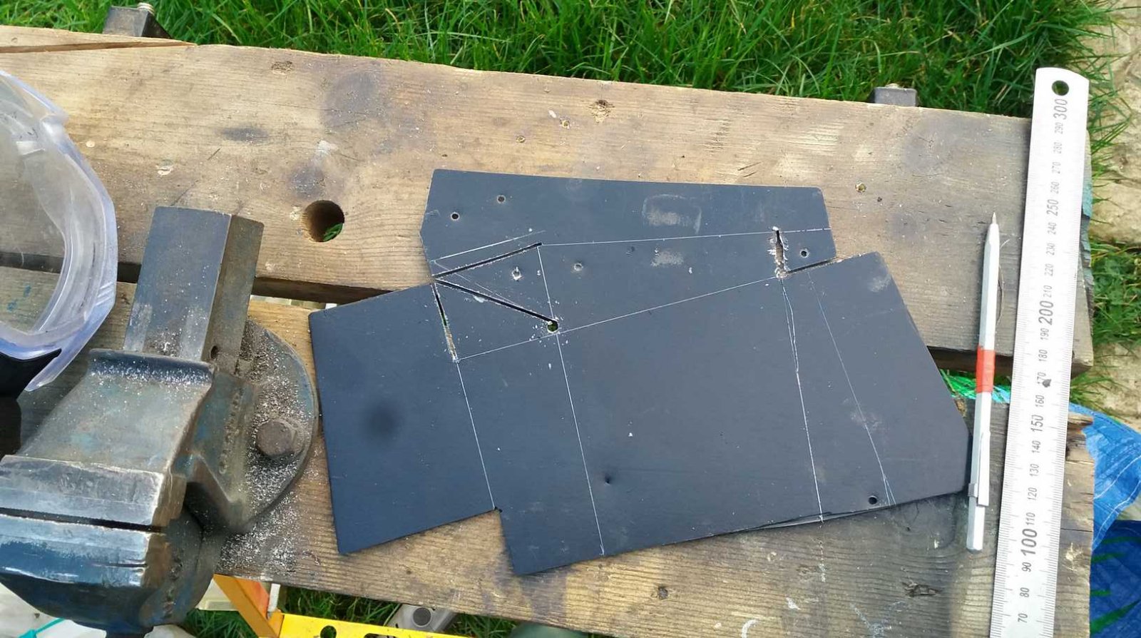

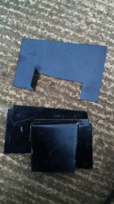

Meanwhile, I've also been making bracketry for the Corsa Header Tank, the 'main' one will go behind the Vauxhall Bracket (not shown). The 'extra' flat-ish bit is intended so that I can temporarily 'hang it off the top of the Bulkhead' a bit like you would with a Picture Hook
Its still 'madness' here with Daughter's car search having re-commenced. The 206SW owner kindly let me out of the deal without penalty when the MOT it was agreed it'd be sold with showed up Advisories regarding 'Exhaust Gas Fumes from an Injector' and play in the Steering Rack Inner Tie Rods...
...there were some trifling 'Fails' too of no great consequence, that he was happy to sort.
but I wasn't really sure how about how serious fix the leaking Injector issue could be. Something I'd read about 'Coal' setting rock hard when an Injector leaks seemed potentially very worrying and I could do without an awkward Inner Tie Rod job in a year's time, both sides of the Rack.
...so the search is back on. And there's not much out there. A Nissan Micra 1.5DCi is possibly going to be viewed soon. Anyone know what the Nissan 1.5 Diesel is like, in terms of common issues / reliability?
