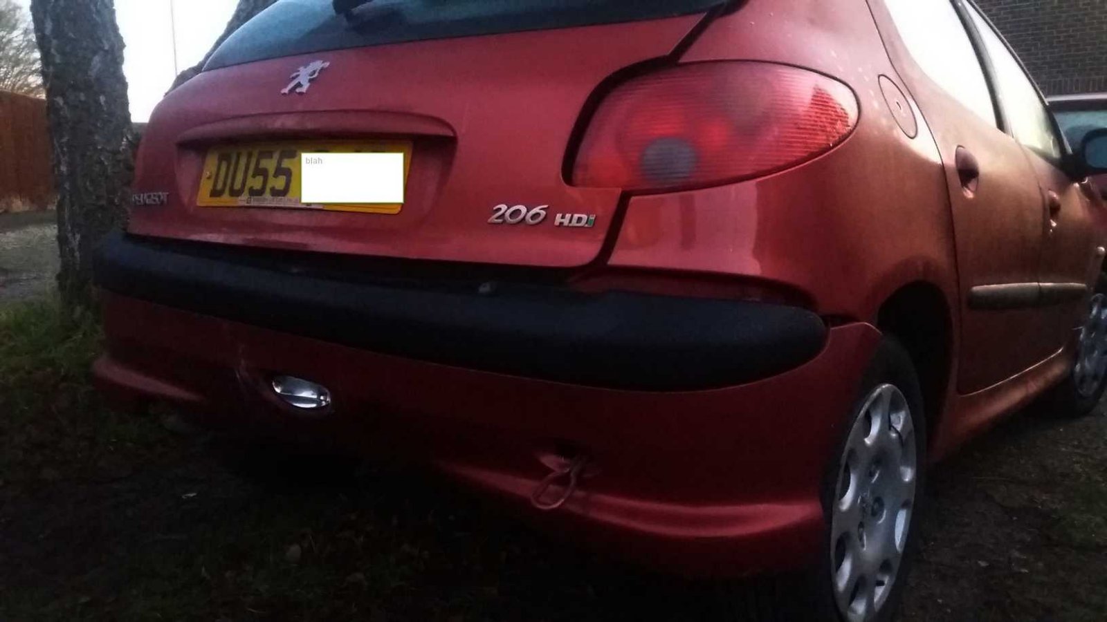

indeed yes, and this one 'd be all the lovelier if some [bleep] hadn't shunted it yesterday!!
Two owners from new, living in the same little Close, then step-daughter gets it, does only 400miles in it and now its a write off. I'm going to investigate the practicality of having it for myself, in particular with regard to Insurance; as its too good an opportunity to miss, even if it is a bit small....
...if all goes horribly wrong with the 405, it'd be an excellent little stop-gap, including to get me to to the South of France to find another one.
Damage is limited to the Boot Floor and possibly the Bumper (no creasing to the rear wings or roof) so could well be an easy fix; and it'd be a damn shame for such a mint motor to meet the Crusher, it really was in outstanding nick.
Anyone interested, if I choose not to have it (ie if insurance cost is prohibitive), put your hands up.... further info will be made available if relevant.
Other party's Insurers (Gold Star for E-Sure) have at least acted swiftly and daughter already has a '19' plate hire C3 to run about in for now (a sea of plastic, much of it cheap & nasty looking... and a tappety sounding engine despite only 9k on the clock - surely its not supposed to sound like that, I must be mistaken...)

Ouch, what is it with 206's getting rear ended lately? damn shame, but at least the other driver stopped and insurance are stepping in for you. If you do get the chance to buy it back give me a shout if you need any rear end parts, obviously the parts car bumper is already spoken for but the only other bits I'm taking from the bodywork are outer quarter panel/lamp recess and inner arch supports I think. (the parts car is China Blue, '04 plate).

Short version is I'd want to repair that properly with new panels if I were thinking of it's long-term future as a tidy nicely cared for car, you could likely bash/pull it out to where the tailgate would shut, & fix the foglamp and still pass an MoT with not much in the way of repairs but if you could stand forking out for another 206 as your stopgap (with short MoT and rust/rear axle issues looming as that kills prices) then you would have all the parts needed ready and waiting once you'd got the 405 reliable once more & could end up with a very tidy, cheap to run and super reliable spare car for not much money at all.
Of course this is just from looking at the photos & maybe it looks worse than it is. Considering that a repaired write-off would be hit in the resale value a "proper" repair might actually be a silly idea if you can bash it vaguely into shape and have the hatch close/seal ok. Just be sure the "chassis" legs aren't kinked at all since that may be a safety/MoT issue & I notice the towing eye has had a whack, fortunately avoided on ours.
Sorry I've not been much help have I lol, my instinct would be try to make it right and have a nice car but not sure if there's any real-world point in having a mint boot floor?

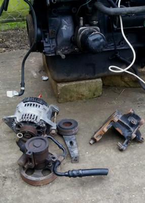

Getting Back on Topic....
some progress with the engine
PAS Pump and Alternator fitted with suitable Cast Iron mount (which could really do with a coat of paint), Aux Belt and Lollipop. These might come off yet, but I wanted primarily to ensure that I had small parts such as fixings 'readily to hand' when it comes to final fitting.
PAS Pump has a replacement 'feed' pipe as this will be lower down in the engine bay than it was previously with the AC & PAS set up
Also fitted is wiring for
Glowies
Stop Solenoid
Starter Solenoid Its not yet got a Fuel supply, but hopefully with a feed from a Gallon can and priming; it'll fire up.... I'll probably give it additional support from the Hoist too. It appears from turning it on the Starter that its inclined to 'fall forward' (ie onto the alternator, rather than onto the Inlet Manifold) hence the placement of the two bottle jacks.
...oops, only one at the time the pic was taken, there's a second under the Bell-Housing.
