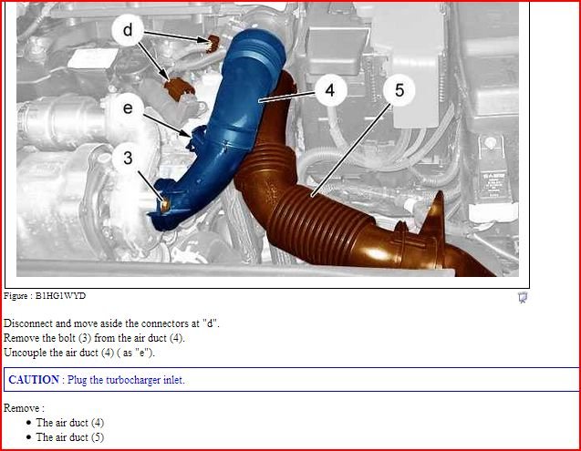

Richard, have you got a pictorial guide to removing the air filter and the parts on top of the engine so I can see all the injectors and wiring loom plugs to injectors?

Can't easily see which way they are numbered. Have you got a fault on a specific injector? If re-coding then it normally gives you a picture to identify them.
Removing the air filter etc:
