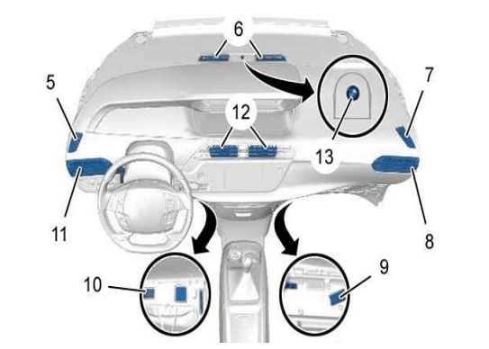

Have a look at this diagram and using the numbers, can you make it clear which vents are hot or cold when both left and right heating controls are set to hot temperature(when the car has warmed up of course).
This will help identify if it is the right or left mixer flap reduce that is likely to be faulty. Once I know this I will be able to put something together for you (possibly not today as we have guests):

today i checked the temperature coming out from vents and all i can say is,that only from vent number 11 above the air is properly heated (all setting left and right were applied to HIGH)..there is also some not so cold air coming from vent number 12 (on the left side - right side is cold as hell) and 10. Every other opening (also at the back) is giving very cold air (AC on or off no matter)
any suggestions what to check ? Maybe matrix heater or something like that ? Flaps,motor,etc
tnx
Janko from Slovenia

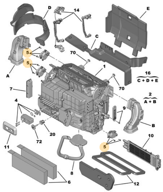

You misunderstand. Those are not what I'm talking about. There are (depending on options fitted) both air mixing and air distribution flaps that are for the most part electronically controlled by stepper motors and these are buried in the heating unit inside the dash, they are not on the fascia. That's why I need your VIN as there are different heating systems fitted, and that will tell me which system you have. I can't help you without this basic information.

- x 6958
Re: C4 Picasso 2015 (B78 plate) Heating problems
Ok, so the motors I referred to are items (5) in the diagram.
The one on the right, and the lower one of the 2 on the left are for the air mixing function of the heater. These mix the hot and cold air.
Thanks for diagram. I will have a look tomorrow if they have any signs of life.
