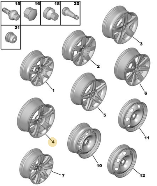

Re: Peugeot 308 CC - new tyres for a new southern summer
So spec. says "ALLOY WHEEL + STANDARD TYRE" for the spare wheel.
And as for the wheels - you have (4) below, so no (11) or (12) which are the 'bare wheels', steel most likely.
As for TPMS, there's nothing to say TPMS are fitted to spares or not these are generally not fitted to steel wheel spares onvehicles with alloys - but on your car they have specified an alloy for the spare, so it is possible that it may have been replaced with an alloy from a vehicle that did have TPMS at some point if not yourself.

I think that you misunderstood me. The car has 4 wheels with tpms sensors, and one, the original spare, without. But, as far as I know, no tpms monitoring is installed.

I wonder if these wheels (with sensors) are original to THIS car? Maybe somebody in the past bought them second-hand (because they liked the look of them) and they came with those sensors as well?
