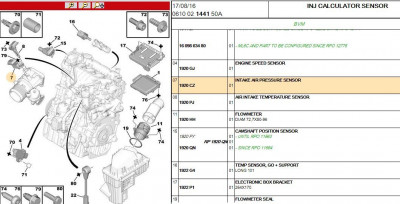

RichardW wrote: 05 Dec 2019, 07:37 I suspect the pressure sensor (or wiring) has had it. As to where it is.....????
Right on the front of the engine by the looks of it :rofl2:
£95.96 from Citroen mind you.... but available for <£20 from the bay of evil :lol:

In my case the problem seems to be (at least so far) damaged and leaking boost pressure sensor.
Found out that some previous owner has broken the sensor plug. Sensor was attached with some gasket sealant but was slightly leaking.
Didnt have new sensor on hand so reinstalled the sensor with sealant and added a cabletie to hold it firmly on place.
So far so good, no fault codes yet with a few days of testdrive.
I'll order new sensor and install it later.
