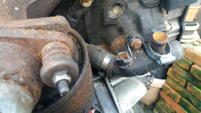

this is a bit all over the place, coz once again I've changed 'direction' for the moment. I've not made any attempt to power up the Starter Solenoid yet, instead it became more urgent to have the car useable following my comment re
A bit of thought suggested to me that my 'pin prick' bodge in the Bypass Hose was no longer sufficiently venting the Air created by the weeping HG so I needed to come up with something more effective....
I'm going to leave it at that for the moment, as I've not even transferred the photos of the fix to my PC yet, I'm aware this is all becoming very confusing, hence a reasonably short post is in order.
Its also daylight hours as I write, so I can be getting on with further car works; a bit cold, but needs must.

a quick addendum to the previous post, showing 'the latest bodge'
The Bleed Screw is back in its rightful place on the Bypass Hose and the original Header Tank is plumbed 'in line' with it. I'd anticipated that I'd need to run it with the top off, but it seems to be OK, and is running at maximum of this shown temp (there's no stat) with slightly better than tepid air out of the Heater.
The leaky rad (I have a new one) might be relieving any excess pressure, but its a fix for the moment. Here's to a successful 60mile round trip tomorrow. PS: I wasn't being over-fussy was I, rejecting a prospective car purchase for a momentary Timing Chain rattle when started cold? Lasted about 2 seconds. A Toyota Yaris 1.0 VVTi

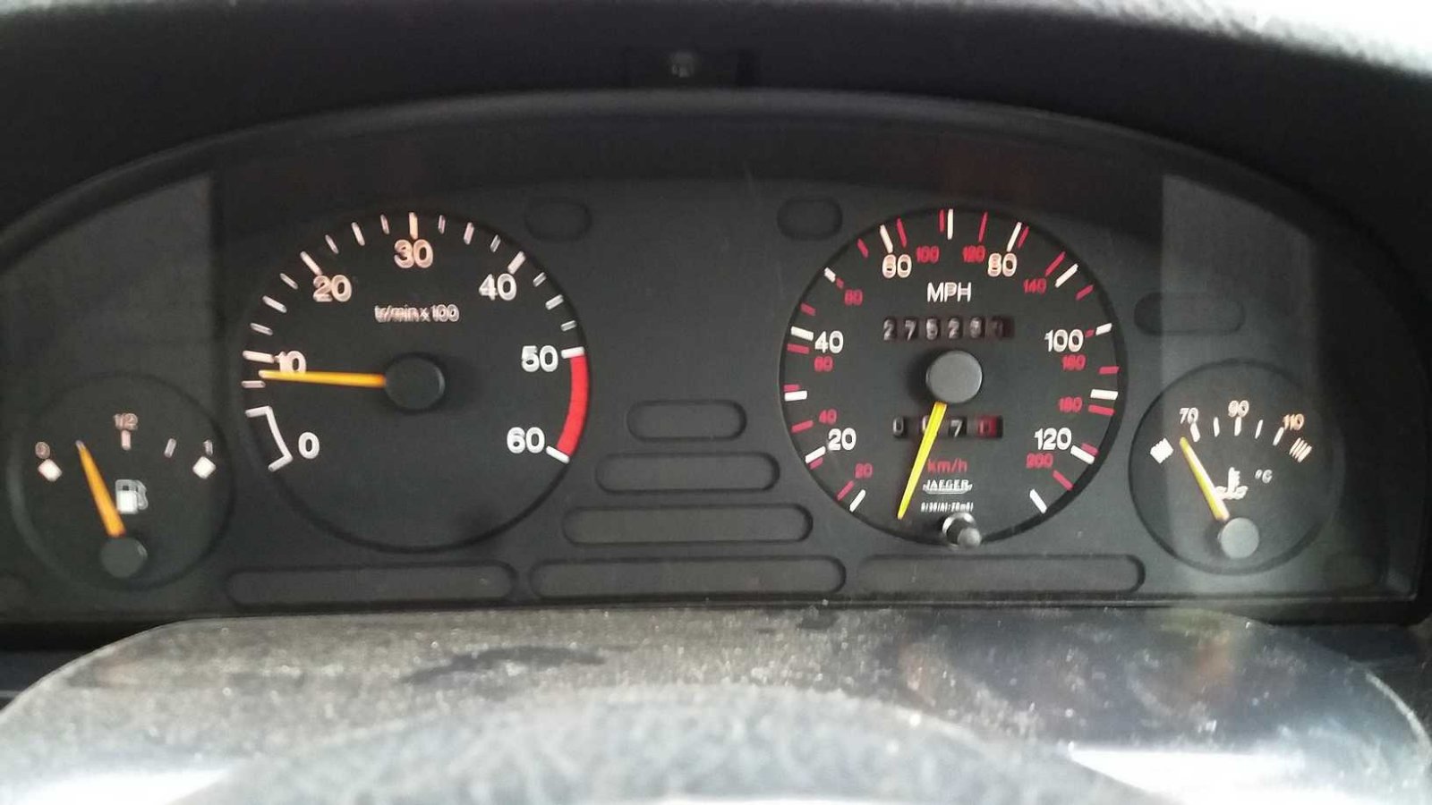

Having "flow" through a header tank is ok, provided it's not too full-force . . . small snouts and connecting it with a small hose (not bigger than 15mm bore) usually ensures that. Many cars have flow though their header tanks, which also double as de-aeration (swirl) chambers, and so collect trapped air at a highest and harmless spot.
Interested that you seem to have a properly warmed-up engine (?90C), but lukewarm heater. This shouldn't be happening, because the heater matrix is plumbed in straight across the head/block, and should run at the same temp as it.
You could have a blocked heater matrix, or the air-control flaps on the heater matrix box are not doing their job. To check whether there is decent flow through the heater matrix, locate the two hoses leading to it (easiest usually in the engine compartment) and use a hand on them to check whether hot water from the head is going to, and returning from, the matrix. If you can identify the Return one, as the engine heats up from cold, it should feel roughly the same temp as the engine block/water outlet/thermostat/temp sensor housing. If it feels much cooler, suspect poor flow through the matrix. It you have to replace the matrix, Nissens brand can be recommended (eg from Mister Auto).
DId you say there is no thermostat installed? That will seriously delay/prevent the heater matrix from delivering hot air, because the main radiator will always be fully in circuit. If this is the case, the readng from the gauge is very suspect, ie may be showing properly hot when the engine block (and matrix) isn't. Check the water outlet/thermostat housing with a thermometer. Is the sender the correct one for the gauge?

Thanks again. It’s a 10mm Bore on this so it should be fine, it seems to favour running at about 1/3 full; and so far the Cable Ties are holding it on just fine... you know its properly bodged if its held on with Cable Ties!
I have just yesterday, acquired a pair of 405 Heater Matrix Supply Return Hoses, so hopefully I can do a mock up with the BX Bottle soon, as a permanent fixture.
The engine’s not getting up to temp, look again at the gauge which I gu-estimate represents about 60c; so the lukewarm Heater is a blessing rather than an issue and the Waterpump mentions, thank you both; don't apply. I've never seen a plastic-blade pump for these, but I'm not saying they're not out there.
The Stat, if it were fitted should open at 83c which is of course its ‘Normal’ (quite cool by modern standards I think) and its now usually running at the temp shown which I’m guessing is about 60c.
Its never had a Stat / its been jammed open for the entirety of my 8 years and 94k with it, with my I think well documented cooling system paranoia I’ve never checked; but once I’ve got the / a new lump ready I will be fitting a stat to this one to see how it behaves before it comes out
I think its possible that my ‘lagging measures’ contributed to the worsening of the HG weep to Gatwick & back, my logic is coz of the greater pressure at higher temps; I had air-flow to the rad blanked off in its usual way. I’m happy to have it back in use so it’ll ‘stay cool’. Performance does of course suffer and quite noticeably, as will MPG I’m sure, but primarily I just need it available to use.
It seems I do have poor flow through the Matrix though: thanks for that Chris [smile], so I'm gonna have to do this again! I’m not using the available cut the structure near the Glovebox ‘Hack’. The return has always been a lot cooler than the feed and sadly it seems that’s not normal; I was thinking it was.

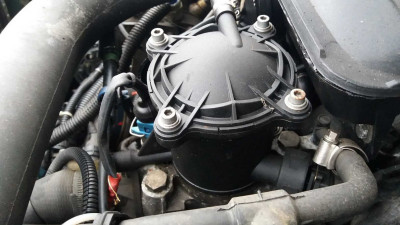

that mystery green sender behind the Fuel Pot on mine, that was mentioned earlier in this Thread…
Its not present on this na D 405 (on a K, reg and Chassis numbers available) that donated its Matrix Hoses. Disconnecting mine when I had the Airbox off mine and easy access seemed to have no effect, but it had stood overnight, so it was cold, its on the list to try it again with warm coolant before the lump comes out
I was blooming sad to be robbing it of bits by the way, as it looked really sound and well looked after, but its motoring days are clearly over so its the only kind thing to do
