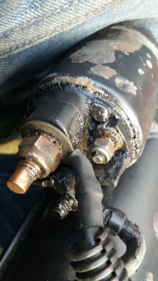

Can't tell from the video but which terminals are you bridging? Intuitively one would bridge the 2 large ones but this will give the issue you have here since it only powers up the motor but doesn't "throw" the solenoid out.
Way to do it is the battery side large terminal (permanent +) to the small terminal that the signal wire goes to. It's possible the solenoid is sticking but as you've moved the pinion out by hand I wouldn't think so.

Are you shorting to the small terminal on the solenoid?

I think you've hit the nail on the head there ekjdm. Another look at the Starter clearly demonstrates there's a small connection I'd previously overlooked. So big Thank You :-D
I was about to pack up for the day when I read it so I didn't get a chance to 'test the theory' but I'm confident it'll work next time with a power supply to the little connector.
