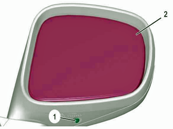

Trim Removal Tools(1) Ambient temperature sensor on the right-hand
exterior rear view mirror.

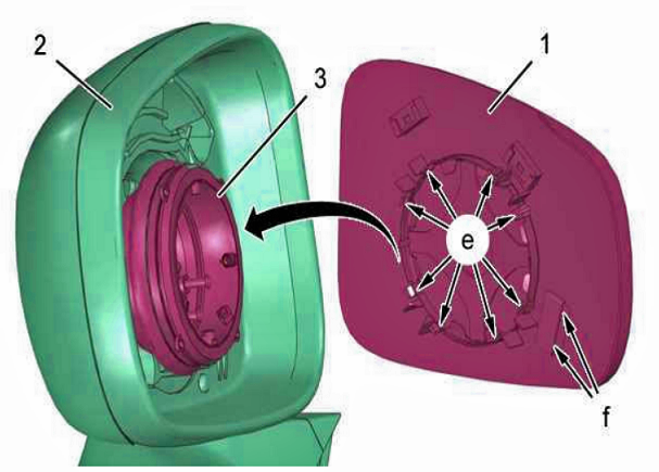

Remove the glass (2) of the right-hand exterior rear view mirror.
Angle the glass (1) of the exterior mirror (2)
(following the arrows "a", "b", "c", "d") to detach the glass (1)
from the exterior mirror (2)
( as "e") using trim tools.

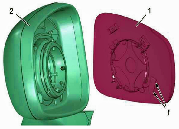

Disconnect the exterior mirror
deicing harness (2) on the glass (1)
( as "f"), using trim tools.

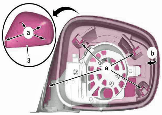

Detach the shell of the rear view mirror (3)
(at "a") using trim tools.
Tilt the mirror (In the direction of the arrow "b").
Remove the rear trim (3).

Reconnect the exterior mirror deicing
harness (2) on the glass (1) ( as "f").
Note: At the same time clip the glass (1) on the motor (3) of the exterior mirror (2) ( as "e").
