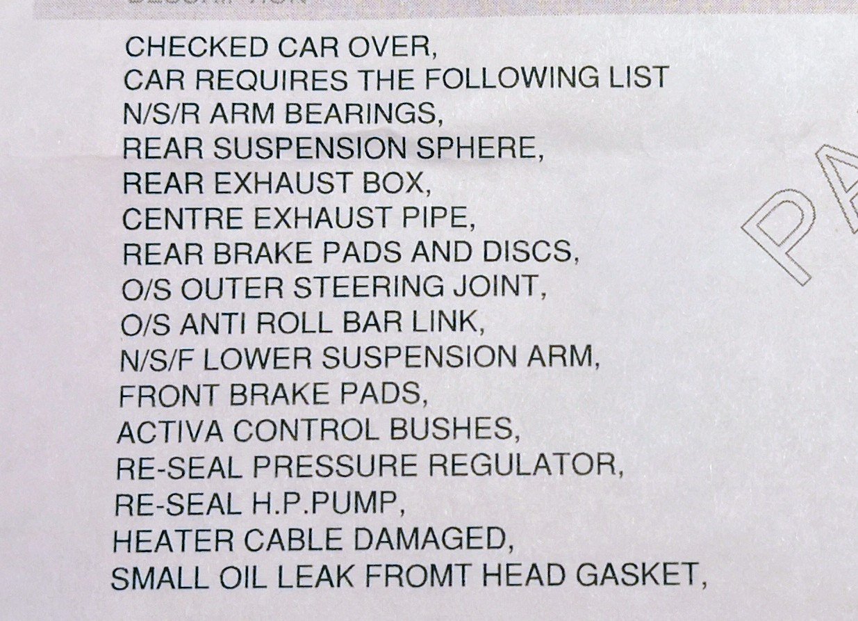

Well that visit to the garage could have gone better.
They reckoned somewhere in the region of £1500 worth...even taking into account that I had some of the required parts already in the car.
Ow.
Looks like I'll be getting my hands dirty over the festive period then!
Ow.

Ouch!
Well, if you are going to do the rear brakes you might need new callipers (because of that bloody corrosion), and I would suggest then putting some gasket paper between the arm and the calliper to protect them.

& I was concerned about mine needing front brake flexis, a bottom swivel, trackrod ends, the handbrake adjusting (how in heaven's name?) & one r, wheel arch patching up (alright - refabricating), oh - & some tyres.
Working over Christmas isn't on (it'd mean staying up in London) - although was going to tinker with the C15 (huh, if only) (substitute red Cherokee) &/or tidy up the electrics in the boot of the Eldorado. New Year's day is another matter though - as have resolved to come back up early to spend some rare daylight hours grovelling under the front of the Xantia (really must get shot of that STS though - oh how I'd like the use of that lock-up).

We will just have to see what state the calipers are in when they come off. Hoping that now I've got a pretty beefy rattle gun getting the caliper retaining bolts out shouldn't be as much of a headache as it has a reputation for being.
Need to make a decision on the exhaust. Do I go for the cheapest system on eBay, planning to get the stainless system I've been wanting since day one...or go for something priced more middle of the road?
Could just go ahead and get it done now...but it's not going to be cheap...and I'm already £400 in to this now and I've still a load of bits to buy!
She's out of test as of about a week ago Davie, but won't be staying that way too long. I'm going to guess 6-8 weeks depending how time and weather behave.
Getting the Lada a test is probably going to be prioritised at this point as it needs less for it, and we're pretty close to it being ready to move on...which will give me another available vehicle to fill in while the Activa is in dry dock.

Be careful using the rattle gun, as the bolts are supposed to be high tensile steel. The perceived wisdom is to use a long breaker bar and a steady application of force.
- Posts: 12600
- x 1490
That's a reasonably long list, Zel, but all spannerable if you are not under pressure! You'll need to see if Sir Jim will come round and supervise if you make him a cup of tea - although finding time when he is not wearing his bike or legs out might be difficult!
The rear calliper bolts are 12.9 HT, and also M9, so getting replacements is difficult - I would go with cleaning up the back of the arm and applying some plus gas, then copious heat on the lug on the arm, then extract them carefully with a long breaker bar. I've done several and not broken any yet.

Duly noted. I'd always been under the impression that an impact gun was usually the lowest risk avenue to get tight bolts out without shearing stuff. Every day's a school day.
While it's not as critical as if I were commuting, there is some degree of time pressure as this is my main day to day vehicle. The Invacar is currently off the road until my replacement hub turns up (reliant on someone else stripping their spares car...so no firm timescale on that), and the Lada has been laid up for the winter...so the van is currently the only roadworthy vehicle I have.
Hoping to have the Lada on the road again within the week, then I can get the swap deal with that sorted and I should at least have a roadworthy car that I don't feel will dissolve the first millisecond it sees salt on the road at my disposal at least.
