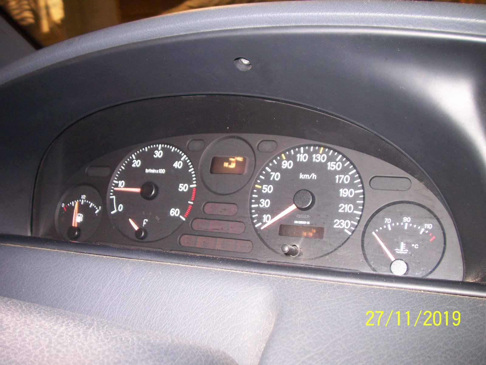

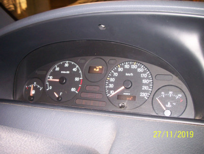

I live in France & today my lhd 1999 (2000 model) Roland Garros spec 806 failed it's 2 yearly CT (French MOT) because the kilometrage could not be read. The little screen along with the other little average consumption etc screen have been illegible for years now but apparently the latest rules fail a car which cannot show how many Km's it's driven.
I'm not bothered about the consumption screen but do need to get this otherwise impecable car through it's CT.
Both screens show part of the info so not completely dead.
Any help as to what the problem might be will be greatly appreciated.

It's obviously not a bulb gone, but looks like the instrument panel itself as the LCD displays have gone. This could be down to a bad connection within the instrument panel itself - the ribbon cables - but as it is both displays I'm more likely to be thinking a connection inside the unit, like a connector that has a bad connection. But it could be the electronics themselves providing corrupt data to the display.
Either way, you're going to need to remove the instrument panel to get it checked by someone if not yourself, or replaced if not a connection.
The part number of the instrument panel for your vehicle is: 6101YA - of course no longer available from Peugeot.

Well I ordered, received & fitted the dash unit from Bart Ebben which workd find except the displays are still dodgy with some numbers incomplete.
I got the car through the French MOT with a bit of help from the very amenable tester but now would like to sort out the screen.
Bart Ebben assure me the screen was tested before it left them & have asked "Can you have the plugs and other connections checked and / or cleaned?" so my question is 'how do I do this'? I can only think of using contact cleaner on the plug sockets & work 'em on/off on the unit. I've not a clue where the other ends of the plug looms come from. Any other ideas?
