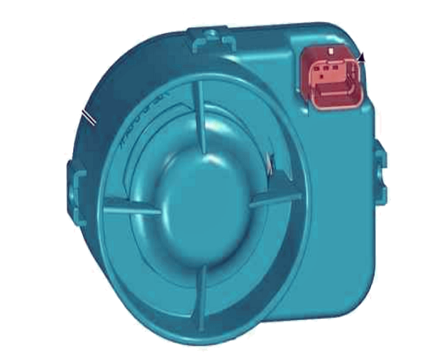

Meanwhile back on topic I was curious to hear about the high pitched alarm sound Mark mentioned as opposed to the horn. My C5 has never sounded at all so I don't know what to expect if it does?
- x 6946
Re: Dealership mode/customer mode
The alarm has a separate siren isolated from the other systems Mick.
The siren carries out diagnostics on its connection with the alarm unit and on its permanent supply.
If the siren detects a malfunction, the siren is triggered.
It depends on your options as to what you have fitted of course.
