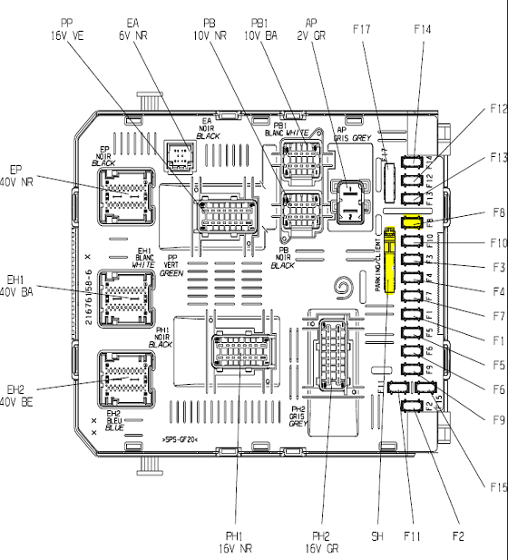

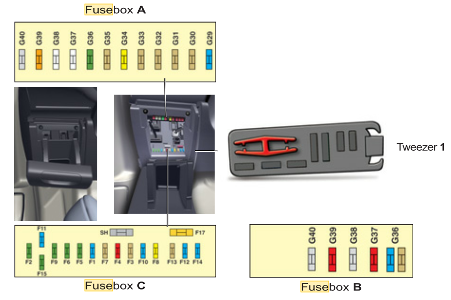

Ok, so taking a quick look, I would first check that the fuse I have highlighted labelled SH in the second diagram and shown below is in the customer mode position. See in the diagram below, Fusebox 'C', there is a grey SH shunt fuse. Make sure that is in the correct position (you may need a torch to read it).
BSI Fuse box - F8 supplies the alarm siren.
BSI Fuse box - F11- 15A Low current immobiliser.
These are the Maxi Fuses that provide the mains to the engine copartment fuse box and to the BSI.
MF4 - 80A Under the Engine Compartment Fuse Box - Supplies the BSI
MF8 - 80A Under the Engine Compartment Fuse Box - Supplies the BSI
