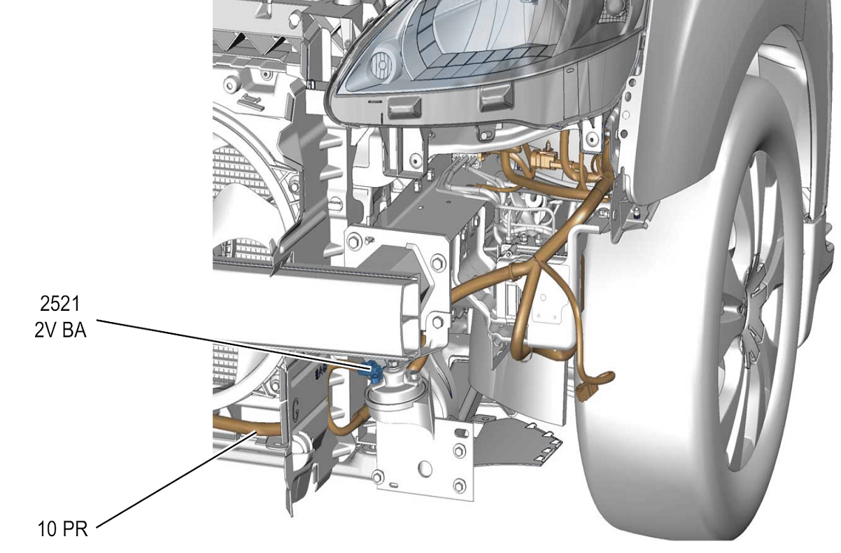

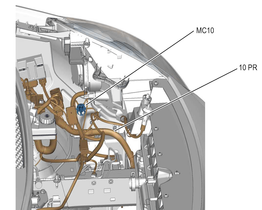

Hi Tony, ok, so you can check fuse F12 in the engine fuse box which supplies the relay, although if it's clicking then I expect it is fine to be honest.
click images to zoom
The horn has a 2 pin white connector as shown in diagram A (2521), part of harness 10PR - and the specific earthing point is MC10 as shown in the second diagram.

Marc, thank you for those diagrams, they were very helpful.
Tony.
