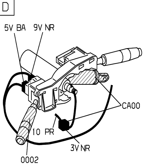

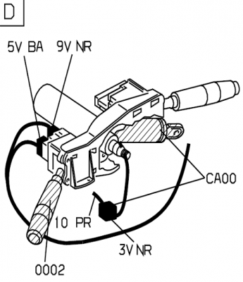

Here's the location:
I would double check the fuses - and actually test them - not just a visual look. - but specifically check F34 as that fuse also powers the BSI which controls a lot of the systems.

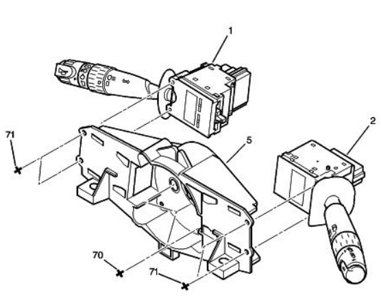

Now if all these check out, then the other possibility is the control unit under the steering wheel (which the lighting stalk plugs into). This unit contains the electronics for all the lighting. When they go, they can cause odd behaviour, like indicator lights playing up, headlamps coming on / going off randomly etc.
This vehicle doesn't have a COMMS Unit, but the lighting control unit seen below does control the lighting.
It is Citroen part number: 625373
A new one from Citroen is not badly priced at £89.52 inc. VAT - but that is brand new / against the price of a used one that is at least as old as yours for half the price......
There are a few used ones - but how long they will last or what condition they are in is potentially a problem.

The changeover to Com2000 light switching came in around late 2001 to early 2002, to operate your horn do you push the centre of the steering wheel or a button on the end of one of the stalks?
EDIT: If the last diagram above is accurate then it looks like a non Com2000 model.
- x 6956
Re: Citroen xsara picasso 2002 2.0 hdi no lights working
It is accurate. Non-Comm model.
