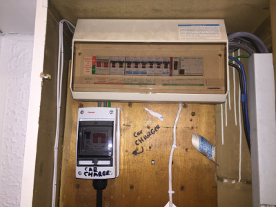

Don't assume that you'll have to replace or upgrade your consumer unit for an EV charge point installation. My consumer unit wasn't suitable either (full already) so the installer simply installed a second "mini-consumer unit" similar to what you might find supplying a garage:NewcastleFalcon wrote: 15 Nov 2019, 22:36 Thanks Mick, Hopefully I will be able to ease my way in with charging via the plug in cable at home, and public chargers for the time being. There is a grant for charging point installations if installed by an approved installer, but before they come along and I need to do a bit of upgrading of our electrical installation. Its fine but old, and could do with "the electricity Board" updating the main fuse, and for us to get the old 6-way rewirable fuse consumer unit replaced with a new one compliant with the 18th Edition of the wiring regs. Has needed doing for years so its about time it was changed in any case.
This piggybacks directly onto the meter tails and does not go through the main consumer unit itself, aside from using the input terminals as a junction point. So as long as your incoming fuse and meter tails are sufficiently rated it doesn't really matter what your consumer unit is.
In the mini-CU there is both a 64 amp breaker and an RCD. From there there is a thick armoured cable that goes under the floor and out through the exterior wall to the charge point, and the charge point itself also has a combined RCBO. So there is plenty of belt and suspenders here, and I actually quite like the fact that the car is not using any of the slots on the main consumer unit, so it's not subjecting it to many hours of high load every day and if the car charge point was to trip any RCD's or breakers etc then it's not going to affect any of the in house circuits. It's effectively entirely segregated.
Before spending a lot of money upgrading all your wiring I would get one of the OLEV approved installers out to do a free quote - they'll be able to advise you on whether you do actually need to upgrade anything or not.

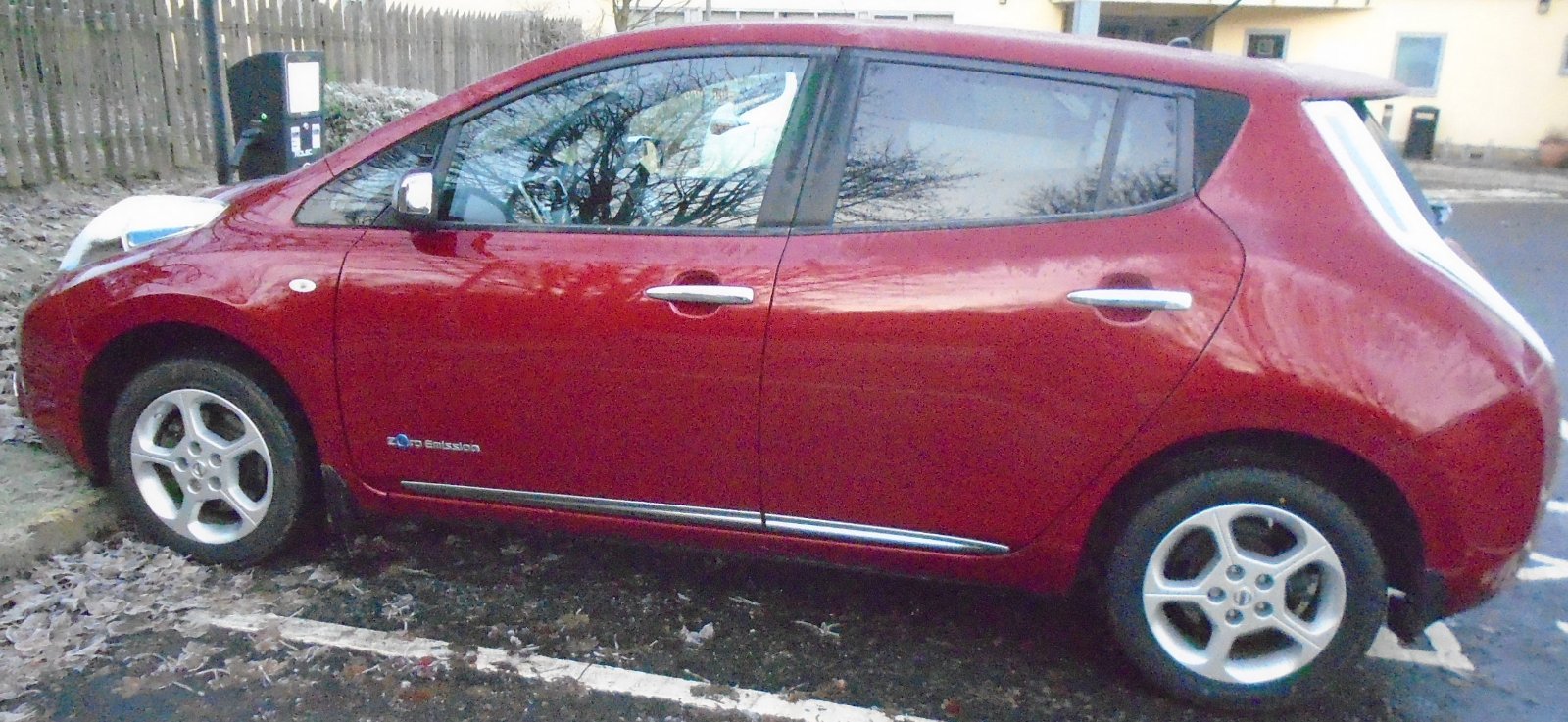

Don't know if it has a heat pump, this is all I know so far. We did a Chademo charge (for free) today and as our friend the taxi driver pointed out we could have the heater on full blast while charging, which I stopped at 85% and we were there maybe 30mins. When driving with the heater on it took the eco "!tree!" indicator down a notch.
Driving it currently on eco mode and "B" which maximises the regen braking, and very much in relaxing pootle mode. Having discovered that charger and the locations of several others, and done our first charge successfully (yes as you well know there is nothing to it really) I am confident that we will manage most of our normal journeys quite straighforwardly. We need about 30 miles to get back home from Tyneside and probably would have had 10 to spare today, but chatting with the taxi driver we just plugged it in to give us the extra in hand.
There is a 7kW charger public charger at the local hospital again free to use so I will plug in the "normal" charging lead (not the 3.3KW one with the plug on) so I presume I have the 6.6Kw charger which should charge up in 4 ish hours.
I will have to dig around some of your old posts Simon where you cover the optimum charging routine for battery longevity. I take it that frequent rapid charges on The DC Chademo are not recommended, but I am sure you will have covered these points before.
Thanks for your advice re the charging point. I think I will ease myself into ev ownership using that free 7kw charger and the odd top up with a free chademo charge. From what I have read PodPoint seem to get a better review from certain others who see the installation of the EV point as an excuse to generate additional works.
The other element of new EV ownership is the "joining" of a scheme, or a few schemes of chargepoint providers. All the more straightforward if you have a smartphone and the appropriate apps. This is something I havent got and frankly dont want, if I can avoid it. I would be happy with a "card".
Thanks again

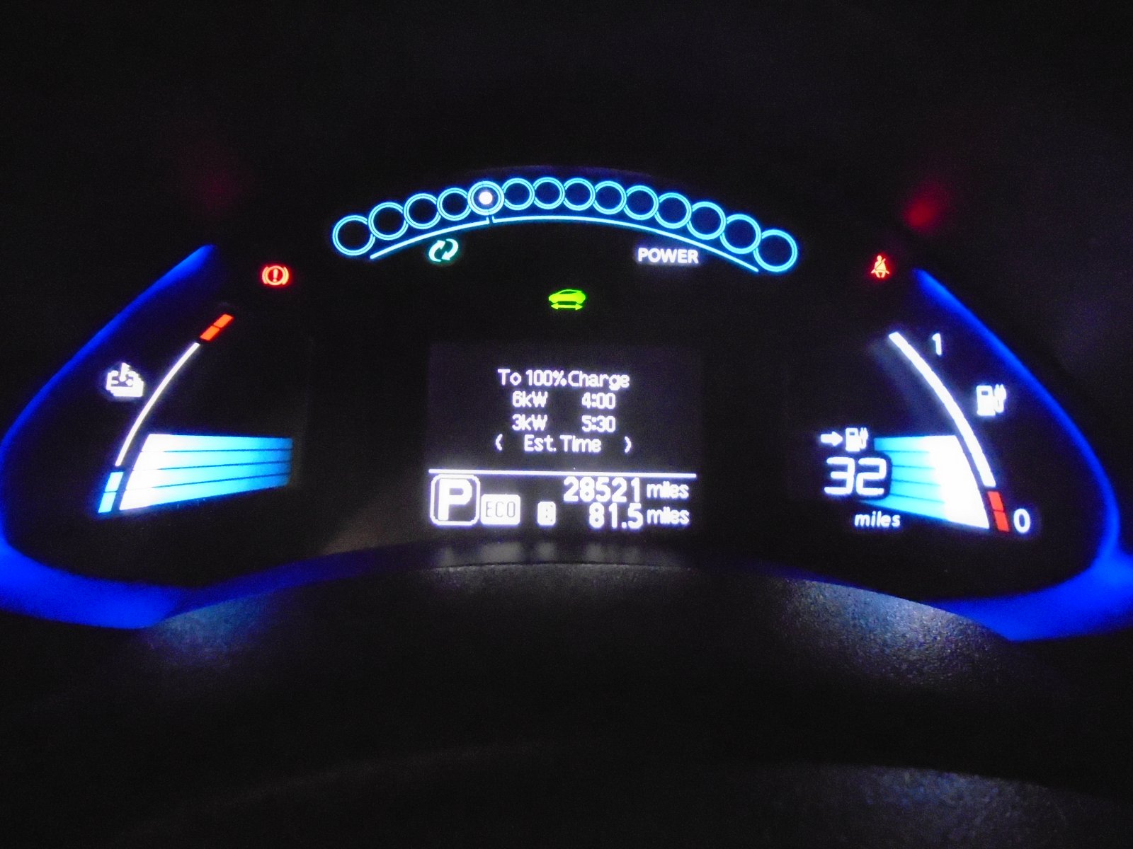

Got the handbook out and pressed a few buttons, so this confirms my leaf has a 6.6kW chargerMandrake wrote: 18 Nov 2019, 21:05 Some Leaf's have 3.3kW chargers, some have 6.6kW chargers which will charge twice as fast on a suitable charge point - not sure what kind Neil's has though! The 6.6kW kind would fullly charge from nothing in about 4 hours.
