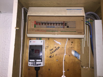

Don't assume that you'll have to replace or upgrade your consumer unit for an EV charge point installation. My consumer unit wasn't suitable either (full already) so the installer simply installed a second "mini-consumer unit" similar to what you might find supplying a garage:NewcastleFalcon wrote: 15 Nov 2019, 22:36 Thanks Mick, Hopefully I will be able to ease my way in with charging via the plug in cable at home, and public chargers for the time being. There is a grant for charging point installations if installed by an approved installer, but before they come along and I need to do a bit of upgrading of our electrical installation. Its fine but old, and could do with "the electricity Board" updating the main fuse, and for us to get the old 6-way rewirable fuse consumer unit replaced with a new one compliant with the 18th Edition of the wiring regs. Has needed doing for years so its about time it was changed in any case.
This piggybacks directly onto the meter tails and does not go through the main consumer unit itself, aside from using the input terminals as a junction point. So as long as your incoming fuse and meter tails are sufficiently rated it doesn't really matter what your consumer unit is.
In the mini-CU there is both a 64 amp breaker and an RCD. From there there is a thick armoured cable that goes under the floor and out through the exterior wall to the charge point, and the charge point itself also has a combined RCBO. So there is plenty of belt and suspenders here, and I actually quite like the fact that the car is not using any of the slots on the main consumer unit, so it's not subjecting it to many hours of high load every day and if the car charge point was to trip any RCD's or breakers etc then it's not going to affect any of the in house circuits. It's effectively entirely segregated.
Before spending a lot of money upgrading all your wiring I would get one of the OLEV approved installers out to do a free quote - they'll be able to advise you on whether you do actually need to upgrade anything or not.

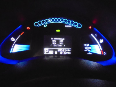

Got the handbook out and pressed a few buttons, so this confirms my leaf has a 6.6kW chargerMandrake wrote: 18 Nov 2019, 21:05 Some Leaf's have 3.3kW chargers, some have 6.6kW chargers which will charge twice as fast on a suitable charge point - not sure what kind Neil's has though! The 6.6kW kind would fullly charge from nothing in about 4 hours.

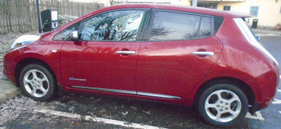

Here we go 1st 7kw charge, free charger, no cards needed, although if you look at ZAP Map the info is out of date. Have just joined Polar+ part of the BP Chargemaster empire. £7.50 a month but gives access to decent amount of charging stations across the country and useful if we stray out of Northumberland on our days out
