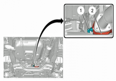

Here you go:

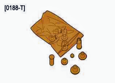

Ok, so the item is number (22) above.This is the Plug Kit

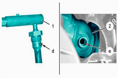

Here's how you remove and refit it:
Location
The vaporiser (1) is to be found on the precatalyst (2).

CAUTION: Blank all the apertures of the
fuel high pressure circuit using the Plug Kit.
Refitting
Adhere to the Tightening Torques! see end of procedure for torque settings.
Position the boss ("d") on the vaporiser (1)
in the spline of the precatalyst (2) (at "e").
