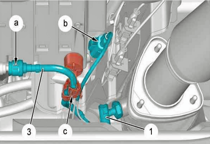

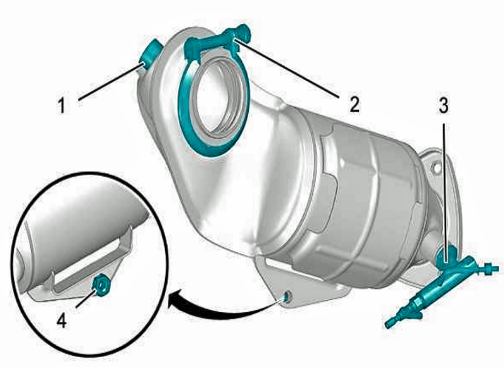

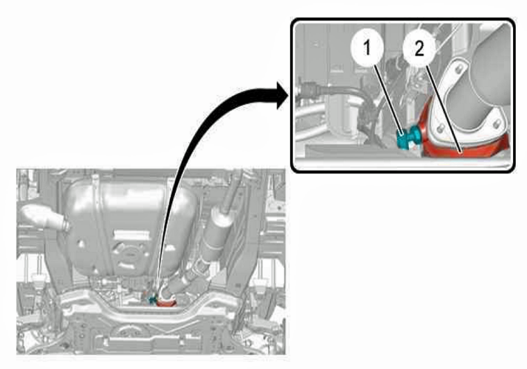

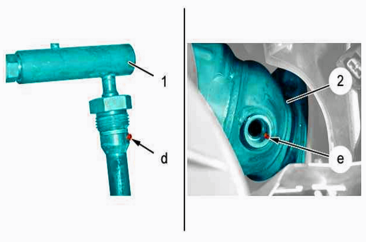

Here you go:
Here's how you remove and refit it:
Repriming the vaporiser
CAUTION: After having performed a repair or a replacement either of the vaporiser, of the metering pump or of the pipe linking the metering pump to the vaporiser, it is necessary to perform the "metering pump replacement" procedure in the RP (replacement parts) menu using Diagbox.
Prime the vaporiser circuit using the diagnostic tool (note the S1279 additional add-on module may be needed for the VCI for commercial vans, or the VCI may not be able to communicate with the relevant system.
Tightening Torques:
| Ok, so the item is number (22) above. | This is the Plug Kit |
| Location The vaporiser (1) is to be found on the precatalyst (2). Removing: Disconnect the battery. Place the vehicle on a 2-post lift. | CAUTION: Blank all the apertures of the fuel high pressure circuit using the Plug Kit. Disconnect the connector (at "b"). Unclip the pipe (3) (at "c"). Uncouple the pipe (3) (at "a"). Remove the vaporiser (1). |
| Refitting Adhere to the Tightening Torques! see end of procedure for torque settings. Position the boss ("d") on the vaporiser (1) in the spline of the precatalyst (2) (at "e"). Refit: The vaporiser (1). Clip the pipe (3) (at "c"). Connect the connector (at "b"). Couple the pipe (3) (at "a"). Reconnect the battery. Clear the memory of faults using the diagnostic equipment. |
Tightening Torques:
