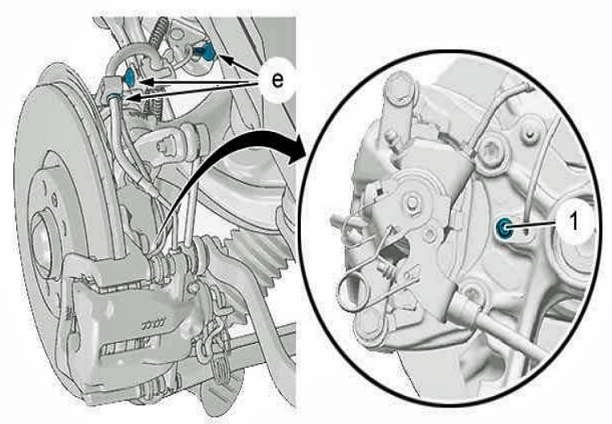

| On the left-hand side Disconnect the connector at " b ". Detach the wheel sensor harness at "a". On the right-hand side Disconnect the connector at " c ". Detach the wheel sensor harness at "d" | Release the harness at "e". Remove:
Avoid contact on the head of the wheel sensor
Note: Grease the body of the wheel sensor (grease - Type TOTAL N4128).
Refit:
- The wheel sensor
- The (1) bolt, tighten to 0,8 ± 0,1 daN.m

- Attach the wheel sensor harness at "a".
- Connect the connector at "b".
- Attach the wheel sensor harness at "d".
- Connect the connector at "c".

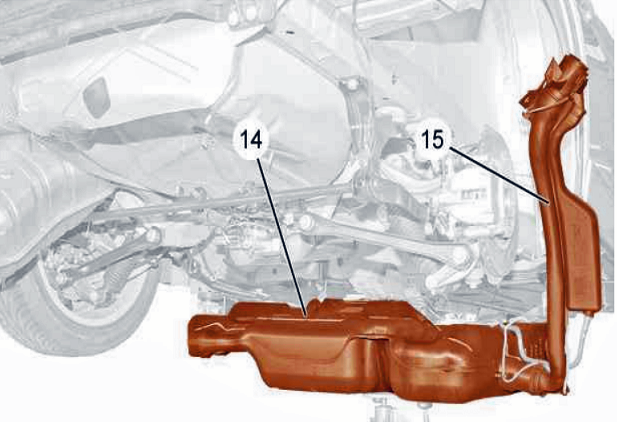

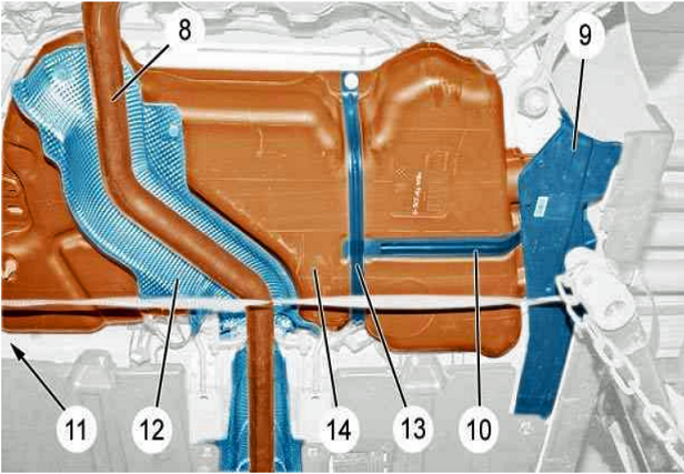

Ok, goes without saying, if lifting off the grounds with wheels unsupported (hanging), suspension on high, remove LDS cap before lifting - then after job is complete, lower to ground, lower suspension back to normal and replace LDS cap (risk of tank bursting).
Tools
Recommended tools are a plug kit and of course a fuel draining machine
Warnings: Respect the safety and cleanliness recommendations that are specific to high pressure diesel injection (HDi) engines.
Removing
Drain the fuel tank.
Raise and support the vehicle, with the rear wheels hanging free.
Remove:
Refitting
Proceed in the reverse order to removal.
Prime the fuel circuit.
Check that the fuel gauge operates correctly.
Tools
Removing
- Keep the luggage compartment lid open.
- Open the fuel filler flap
- Disconnect Battery as per procedure
| Rear bench seat (two-thirds/one-third) Open the rear right door. Raise:
Open the rear right door. Remove:
Unclip the connector "a". Disconnect and move aside the connectors "a", "b" and "c". Uncouple:
Remove:
- The right hand rear wheel
- The rear RH splash shield
| Remove and attach the filler cap (6). Remove:
Remove:
Remove:
| Disengage the filler neck (15) from the seal (16). CAUTION: Take care not to damage the fuel flap seal. Unclip and pull away the ABS sensor harnesses. |
| Detach and move aside the harnesses of the wheel travel sensors. Lower the fuel tank (14) by disengaging the filler neck (15) on the RH side. Remove the fuel tank (14). |

I’ve done one on mine previously. With the tank in place it’s nigh on impossible unless you remove the back seat.
Even with the seat removed you still can’t clip the cable into the guides on top of the diesel tank.
Dropping the diesel tank isn’t a bad job, it’s just time consuming. Follow the guide above and you’ll be fine.
