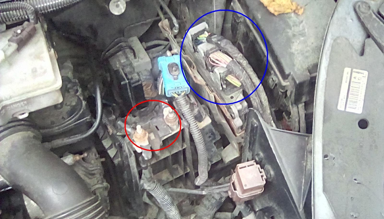

Someone asked before for a photo, so I have uploaded a photo in the red ring of the terminals that if you disconect and reconet there seams to be a clicking noise comeing from around the ECU located in the blue ring of the photo and everthing back working again
But the car has not done this error again; so I have not had chance to try bypassing the starter motor

Craqck pot all your electrical wiring is contaminated with sand and dirts. The connectors junctions and wiring should be properly shielded from the elements to prevent electrical problems. I guess thats where your problem probably lies. Go get a good quality contact cleaner and cleanup all joints contacts etc. But be warn if you start cleaning up you might encounter intermittent electrical issues, so its better to get a friend that is expert in wiring to help. Good luck.
