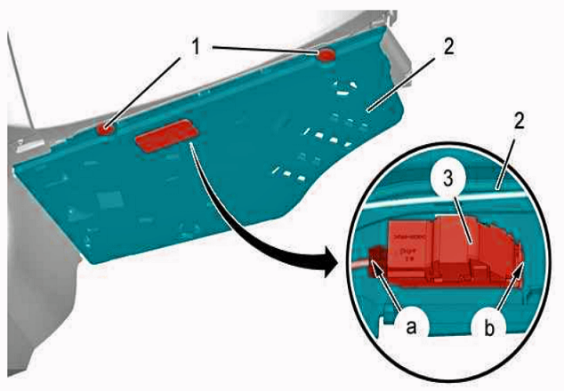

Remove the clips (1) using trim removal tools.
Disengage the trim (2) under the dashboard .
Detach the lamp (3) ( as "b") using trim tools.
Disconnect the connector ( as "a").
Remove:
  • The lamp (3)
  • The trim (2) under the fascia

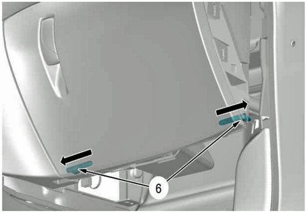

Detach: The pins (6) (Following the arrows).
Remove: The pins (6).

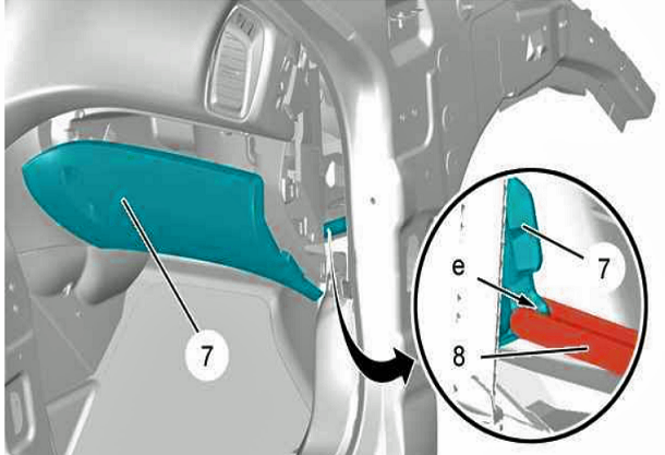

Open the glovebox (7).
Unclip strut (8) ( as "e") using trim tools.
Detach and remove the glove box lid (7).

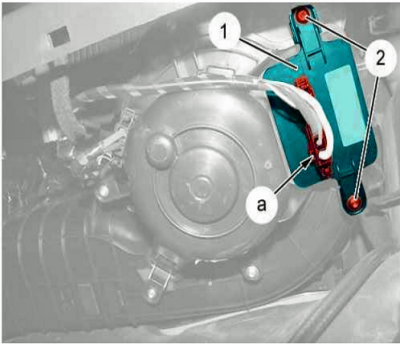

Remove:
  • The bolts (2)
  • The air blower control module (1)
Refitting
Refit:
  • The bolts (2)
Connect the connector (at "a"").
Refit the trim under the fascia.
Reconnect the battery.
Check the operation of the air blower.
