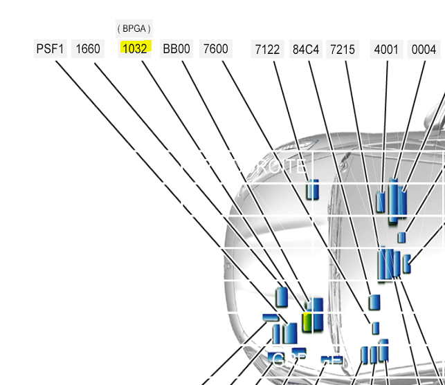

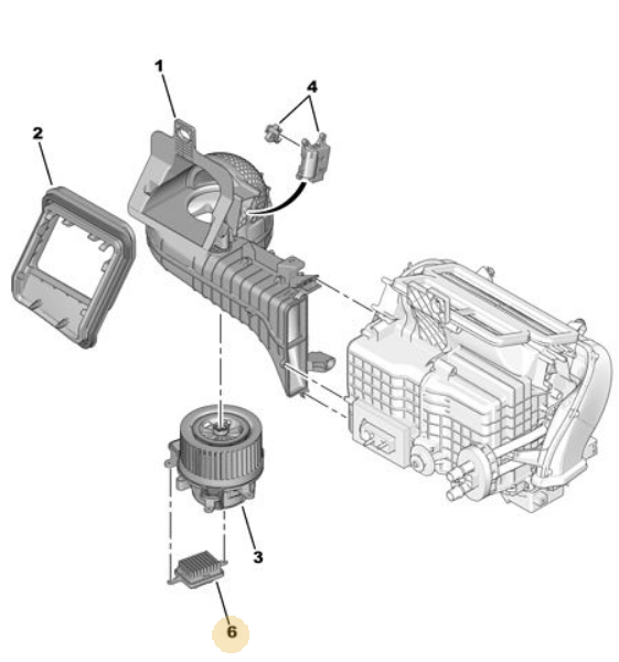

Ok, so on your vehicle the blower motor control module is attached directly to the Blower Motor itself.
The Supplies Unit (1032) I have highlighted in yellow (sort of) to help you locate it in the engine bay - it will be near the battery:

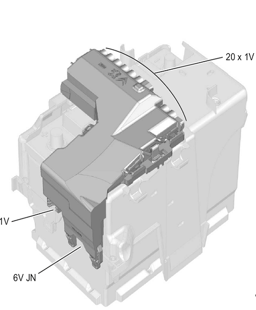

Blower Motor Control Unit - item 6 | The Fuse is F10 (40Amp) and is located in the electrical supplies and management unit that looks like this: |

You are quite the informatiin technician, and i am most grateful Marc, incidentally, for yourself and others, i identified the location of the blower motor and resistor as per your diagram, it is under the drivers side (RHD cars) lower dash, just above the pedals, a hex screw to remove plastic foot rest and unclip the four tabs to lower the small shelf, unplug the footwell light, remove, and hey presto ! there is the blower motor with integral resistor .... five minutes and you're looking at it, you need to be upside down in the footwell and a bit flexible, but pretty easy to then unscrew the two fixings holding the resistor to the blower ..... I will check that blower fuse location you've kindly supplied and get back to you, many thanks again.

Okay, so found the 40amp green fuses under the bonnet, and removed the plastic cover sitting on top of the battery, (not the fuse box cover) the one to the left of that on top of actual battery itself, three or four push tabs and it comes off revealing the heavy duty fuses all the way from 40amp to 125 amp .... two 6mil nuts holding each inline fuse in place, there were "three" green 40amp fuses, removed all three, cleaned up connections with emery paper and re-fitted, all were good and not blown, so I'm guessing next job is to remove resistor from blower and then actual blower itself, might as well check it spins freely if i can get to it, check bearings for moisture/ see if shaft sticking ? .... any more suggestions greatly appreciated as usual Marc .... Thank you.

There are 2 types of resistance - not to be confused with each other. The Blower Motor Control unit (item 6) in the diagram is the resistance unit that controls the blower motor and the speed.
The other type of resistance is the air heating resistance that provides initial heating for the cabin when needed to help the cabin reach warmer temperatures more rapidly.
Your car doesn't have this additional heating though.
