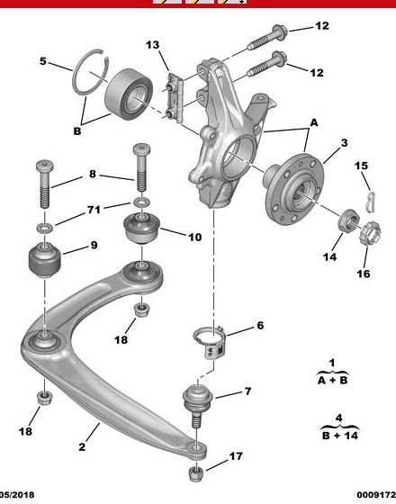

Sounds like a lower ball joint to me....easy for other things as well, do not drive it until sorted !

To your knowledge, have you kerbed it, or hit one of the wheels into an object from the side (regardless of whether there was any physical outward damage)? A knock can affect the power steering internals - so that's one suggestion.
Next, do you get any clunk when going over a speed hump or pot hole, or when braking firmly / taking off? That could indicate a bush on the wishbone worn.

Re: Handling
Unread post by Stickyfinger »
for info:
