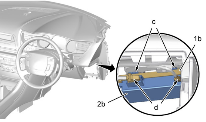

Ok John, so I've checked your specs and you are likely to have a bit of work to do trying to fit this to be honest.
First of all - that module is not compatible for the X7. The connectors are in the wrong location for a start and that part number is not for this model.
Next, you have the RD4 system - and looking at your specification, you only have the items that I have marked with yellow dots in the diagram below. You would require to have the items marked with Red dots too:
Click pictures to Zoom
However, if you were to locate the correct part - the difficulty a friend had was trying to locate the pre-existing microphone wiring end output.
So you'd need the USB cable and the correct module and support unit, then you'd need to configure it to your car's system using Diagbox.
Alternatively, you could source and RD45 unit - which has the blueooth unit built in to the Head Unit, so won't need any extra units to be sourced. The USB cable and socket can be purchased later if you want to have MP3 files played off a USB stick etc. You may need to replace the multifunction screen display for the version to support the RD45 and will need to configure the unit to the car to enable the changes though.
Yellow Items you have, Red you need |
These Pictures show the location of the unit on a right hand drive. |
