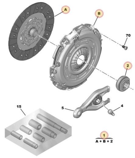

Ok, so you have a manual 6 speed gearbox - non-piloted on this:
Part numbers and prices (inc. VAT)
9800109880 new DMF £662.99
1649615980 recon DMF £625.49
1610211580 New clutch kit £413.02
1610212980 Exchange kit £274.75
The DMFs have a £200 refundable surcharge and the Clutch a £44 surcharge.
This will give you an idea of the parts prices alone at the dealer as of today, so expect anything between £1200-£1500 with the labour and VAT on the labour. But don't forget to get your recall sorted either way - I believe the member who reported back after I informed him yesterday said his recall was in relation to 'Drive Belts & Tensioner'.

Thanks for your Forum donation. Here you go: If you need any further parts, just pop a request up in this thread: Citroen and Peugeot Official Parts Requests
DMF
(10) Original OEM DMF: Part: 9800109880, £853.21
(10) Reconditioned Valeo Flywheel, Part: 1649615980, £467.70
Clutch Kit
(1) OEM new Clutch Kit, Part: 1610211580, £532.78
(1) Standard Exchange Kit, Part: 1610212980, £279.23
All prices are as of today, include UK VAT, direct form Citroen.
