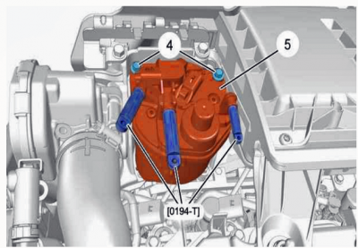

Fuel Filter
Place the tray underneath the fuel bleed pipe outlet (When coupling the tool, protect yourself using a cloth to prevent any splashes of fuel).
Disconnect and move aside the connector ( as "b") (Water in diesel fuel detector) (according to equipment).
N.B.: The water in diesel detector acts as a lock for the water bleed screw (2) on the fuel filter.
Unlock: The water bleed screw (2) (Clockwise);
Raise the water bleed screw (2) fully (In the direction of the arrow ( as "c")).
Allow the liquid to flow out.
Disconnect and move aside the connector (as "a") (Fuel filter heater).
Clean the unions (1), (3a), (3b) using the degreasing product,
the brush and the cleaning tray.
Uncouple the connectors (1), (3a), (3b).
CAUTION: Plug the openings when a union is uncoupled using the tools [1520-B / 5705-T].
CAUTION: Close the pipes on the fuel filter, using the tools [0194-T].
Slacken the bolts (4) (captive screws).
CAUTION: With great care, vertically disengage the fuel filter (5) from the fuel filter support (Risk of damage).
Remove the fuel filter (5).

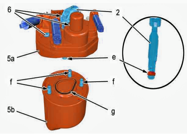

Fuel Filter Element
CAUTION: The water in diesel fuel detector, the priming pump and the diesel fuel heater are integral with the cover (5a) of the fuel filter (5). If there is any anomaly, replace the fuel filter (5) cover (5a) in its entirety.
Check that the centring ring is present (as "d").
CAUTION: Place the cover (5a) of the fuel filter (5) upside down, in a spot that is secure and clean.
Remove:
  • The bolts (6)
  • The filter element (5b) from the cover (5a) of the fuel filter (5) (Fuel filter heater)

Fuel Filter Element
N.B.: Check the condition of the seal ( as "e"); If there is any anomaly, replace the fuel filter (5) cover (5a) in its entirety.
Unlock: The water bleed screw (2) (High position).
Refit the seal ( as "g") (New).
CAUTION: Be careful when positioning of the cover (5a) of the fuel filter (5) (Locating lugs ( as "f")).
Position the cover (5a) of the fuel filter (5) on the filter element (5b) (Locating lugs ( as "f")).
Refit the screws (6) without tightening.
Push the water bleed screw (2) fully ; Lock : The water bleed screw (2) (Anti-clockwise).
Retighten the bolts (6) to the correct torque.

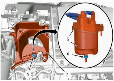

Check that the centring ring is present( as "d").
CAUTION: Very carefully, vertically position the fuel filter (5) in the slot "h" in the support (7) of the fuel filter (5) (Risk of damage).
Fit the fuel filter assembly (5) onto the support (7) ( as "h") (Carefully).
Refit the bolts (4).
Remove the tools [0194-T], [1520-B / 5705-T].
Couple the click-fit unions (1), (3a), (3b).
