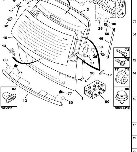

4, There's a plastic trim on the back that covers the number plate lights, it's been glued before but it's falling off again - any suggestions (the new bit is £140)

Assuming the trim strip is item 12 in this diag, then it's supposed to be held on with 6 bolts!!
There's loads up for breaking on e-bay in different colours - find one that's the right colour and get the strip off it.

Thanks Richard, that's exactly what it is (12) it doesn't look like they wasted too much plastic on the fittings. May I ask: is there a download for a decent workshop manual for the C4? I do like to work from a decent manual.
