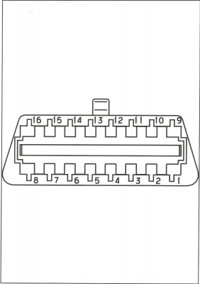

KennyW wrote: 21 Oct 2019, 11:56 Marc,
Do you still have the photo of the ODB 16 pin plug ?
It seems the photo's you posted have vanished or was I looking at another topic !!!!!!!!
Kenny

Marc,
My apologies I was referring to the layout of the pins in the diagnostic socket ie 1 - 16
Thanks
Kenny

I didn't post any photos here Kenny - do you have a link to the other post?

Re: suspension ecu
Unread post by KennyW »
No Marc,
It must be on one of the posts I was looking at but I can't remember which.
Thanks for you help anyway Marc.
I know where it will be in Revue Technic but I don't have one for my C5 x 7
Kenny
C3 1.4 petrol (SWMBO)
x 6948
Re: suspension ecu
So what actually do you need? I think I've identified the suspension ECU pin out to the OBD diagnostic port on the post with the diagram. What else do you require, perhaps I can assist further?

Re: suspension ecu
Marc,
I've found what I was looking for and it is in the Sedre wiring diagrams.
Once logged in, locate your vehicle type etc in Domain,look up general points then sockets etc click on that field then diagnostic socket appears with the wring diagram diagnostic plugged number and a list of the 16 pins and what they do or not do .
I hope this makes sense.
Kenny
x 6948
Re: suspension ecu
Yes, sorry I could of posted that up if you wanted it. Glad you have what you need now.

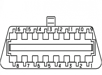

Re: suspension ecu
Diagrams attached
x 6948
Re: suspension ecu
Pin 12 as per the large diagram (the suspension circuit only shows the relevant pin).

Re: suspension ecu
Not sure this is going to help you Kenny - as the Diagnostic port pin 12 is manufacturer - specific reserved and in this case on the C5 X7 Citroen use it for the ABS / ESP and Suspension. It uses a 'K' line protocol and therefore is controlled by a master ECU, so don't expect it to be active all the time.
As this is a single wire, only one ECU can send a message at any time. The messages are sent as 0's and 1's (Binary), and so therefore these are transmitted as a pulsed voltage signal with 12v as a '0' and 0V as a '1'. The K-Line message can be sent in several parts, unlike a CAN message that is sent complete.
Ideally, you would use a CAN testing box to check these types of connections.
channel matching
1 ignition positive
2 not used
3 diagnostic CAN H - BSI
4 body earth
5 electronic earth
6 Intersystem CAN High
7 fault-finding line K - engine management - automatic gearbox - additional heating
8 diagnostic CAN H - BSI
9 not used
10 not used
11 not used
12 fault-finding line K4 - ESP - hydraulic suspension
13 not used
14 Intersystem CAN Low
15 not used
16 battery +ve
