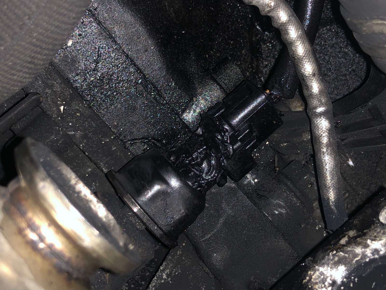

Find this little plug under the EGR , the fuels lines is going in to this. Old EGR valve melted this part. Someone know what this is for?
x 6956
Re: Citroen C5 2009 EGR valve
If it's the 5 pin black plug then it's the EGR solenoid valve plug - controls the solenoid and throttle motor commands etc.

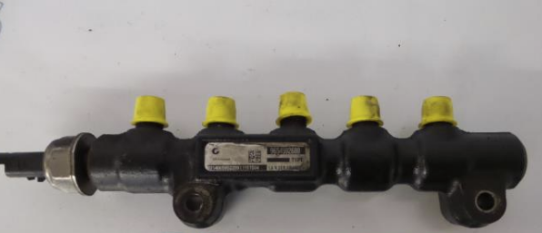

This is the fuel rail pressure sensor. Weird that the diagnostic dosent show this problem. Can someone help me with the oem part number for this part?
x 6956

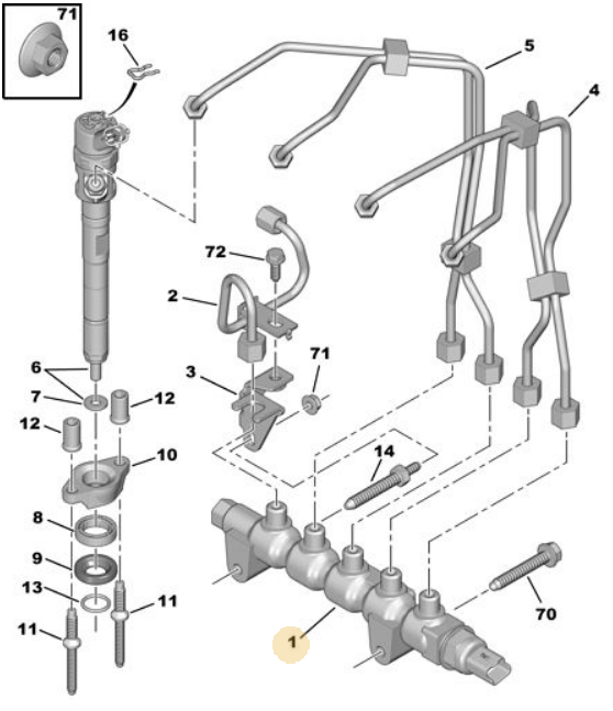

The EGR won't be near the rail - the rail fuel pressure sensor is on the end of the rail here on the right hand side - item (1)
Your photo is hard to identify what you are looking at as it's too close in.
Citroen only sell the complete rail with sensor.

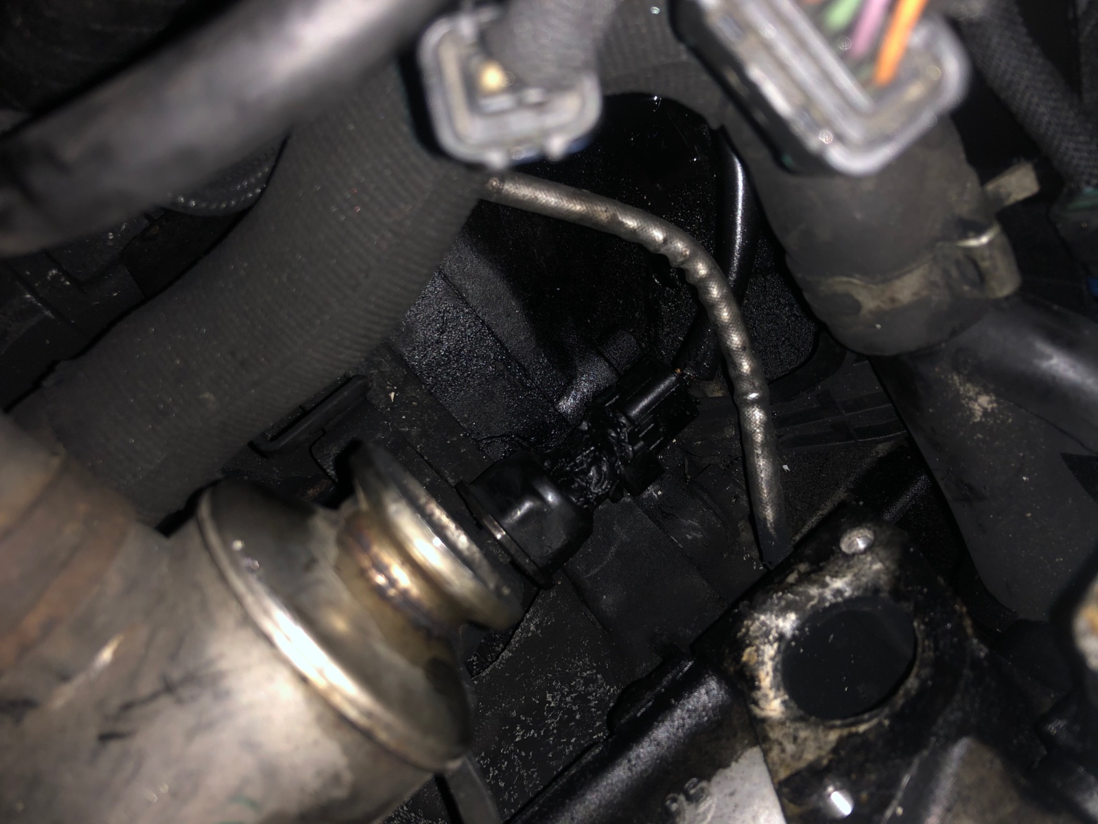

Here can you see that the sensor is right under the egr valve
x 6956
The part for the fuel rail (with sensor) is 1570G2:
You can get the sensors on their own from aftermarket suppliers.
