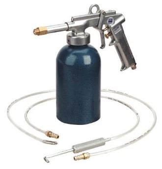

My priority has been for wax on the underside.
Last Rover (P6B V8), BX, and now XM all got thorough underside and cavity waxing, and all remained totally rust-free - really important for hydraulic pipework!
Current kit is now a Sealey SG18 wax injector/spray gun, which uses an air-line (to pressurise the container) and a cavity wax of choice... 4CR cavity wax... less expensive and far more durable than waxoyl.
Other brands available

That's what I used to do, using cheap plant-spray bottles, and warmed waxoyl, with an added long nylon pipe for the sills and box sections. A miserable and lengthy job. The Sealey gun just makes the job quicker, cleaner and less wasteful.
