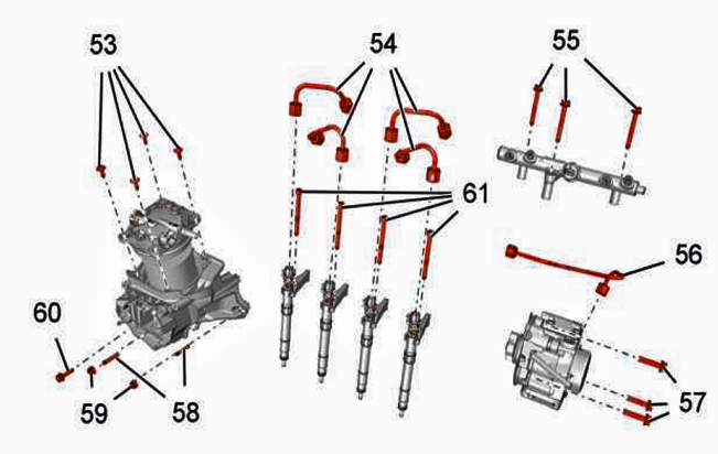

Here you go - I've included the other related components in the table:
Click Image to Zoom
ReferenceDesignationTightening torque
(53)Bolts (Fuel filter )1,1 daNm
(54)Union (High-pressure fuel pipe / Injectors ) (*) (**)Pre-tighten to 1,8 daNm
Tightening to 2,7 m.daN
(55)Bolts (Fuel high pressure rail)2,2 daNm
(56)Union (High-pressure fuel pipe / Fuel high pressure common injection rail )Pre-tighten to 1,8 daNm
(57)Bolts ( high pressure fuel pump)2 daNm
(58)Studs (Fuel filter support)0,4 daNm
(59)Nuts (Fuel filter support)0,8 daNm
(60)Bolts (Fuel filter support)0,8 daNm
(61)Bolts (Injector holder clips )Pre-tighten to 0,7 daNm
Angular tightening to 55°
(*) Follow the tightening sequence (**) Follow the tightening procedure

Marc i really appreciate this thank you! Fingers crossed its just a case of the injector going back in and the car running again
