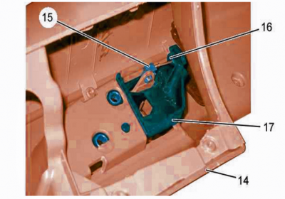

This is part of the door stripping routine - at least enough to get the window out.
Door Stripping
This should be enough for you to get in and remove the window.
Door Stripping
Remove:
| Unclip the upper cover (3) (following "a"). |
| Unclip the door opening control handle (5) finisher (4). Remove:
| Detach the electric window control (7) (following "b"). |
| Disconnect the 2 connectors (at "c"). Remove:
| Unclip and remove the speaker grille (9). |
| Remove the bolts (10). Detach the speaker (11). Disconnect the connector (at "d"). Remove the speaker (11). | Unclip: The armrest upper trim (12) (at "e") (following the arrow ). Remove: The armrest upper trim (12). |
| Remove the armrest (14) bolts (13). Partially detach the armrest (14). | Detach:
| Unclip the clips (at "g"). Remove the panel with liner (18). Disconnect the exterior mirror connector (at "f"). | Remove:
