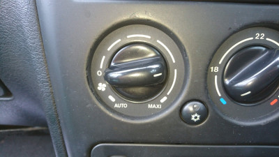

Just wanted to check this observation. Fan is on all the time at constant speed from Auto, 0 then through 1,2 & 3 marks BUT past 4th mark it goes to FULL blast. Would this indicate anything other than a resistor fail?

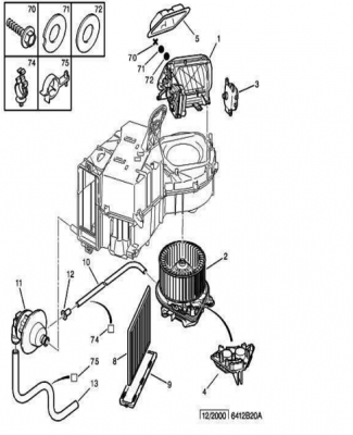

If this is a M II with regular A/C, then the blower control module will likely be located on the blower motor itself, shown separated as item (4) below. Your VIN will confirm.
And most likely will be the cause - it's usually all or nothing - but this is an older type of unit so may exhibit the specific issues you describe.

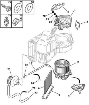

Ok, slightly different - from your VIN:
Part number: 644178. These retail at Citroen for £216.40 inc. VAT.

Re: Xsara blower on (almost) full blast all the time
The part is 6441N4
No longer available from Citroen, but plenty of aftermarket ones available. Just make sure you confirm any replacement comes with the blower resistor module though!
And when you search, make sure you put in ‘Citroen 6441N4’
