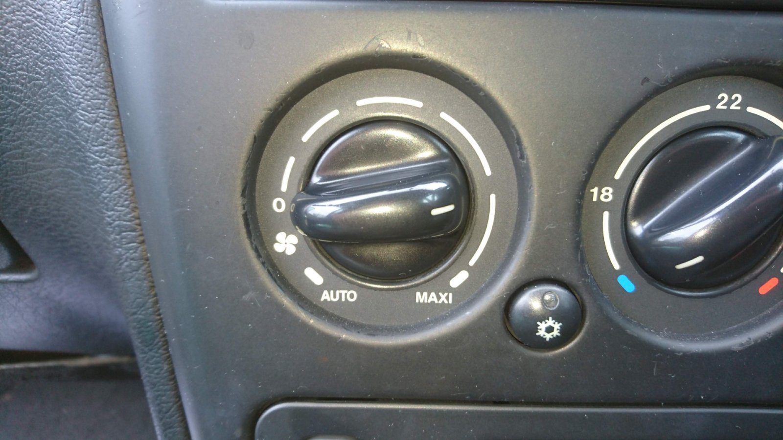

Just wanted to check this observation. Fan is on all the time at constant speed from Auto, 0 then through 1,2 & 3 marks BUT past 4th mark it goes to FULL blast. Would this indicate anything other than a resistor fail?

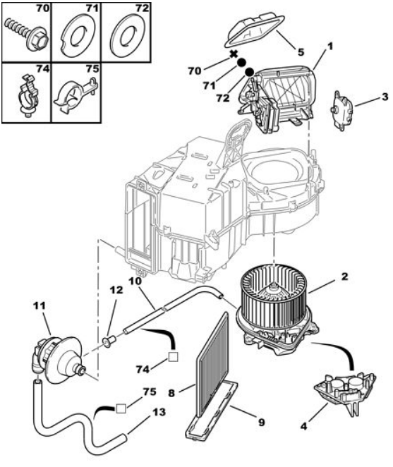

If this is a M II with regular A/C, then the blower control module will likely be located on the blower motor itself, shown separated as item (4) below. Your VIN will confirm.
And most likely will be the cause - it's usually all or nothing - but this is an older type of unit so may exhibit the specific issues you describe.

Ok, slightly different - from your VIN:
Part number: 644178. These retail at Citroen for £216.40 inc. VAT.

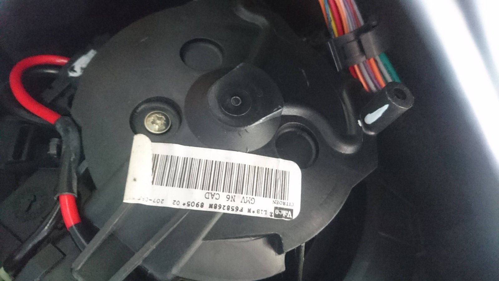

Just took this pic from under the blower as is if its any help?

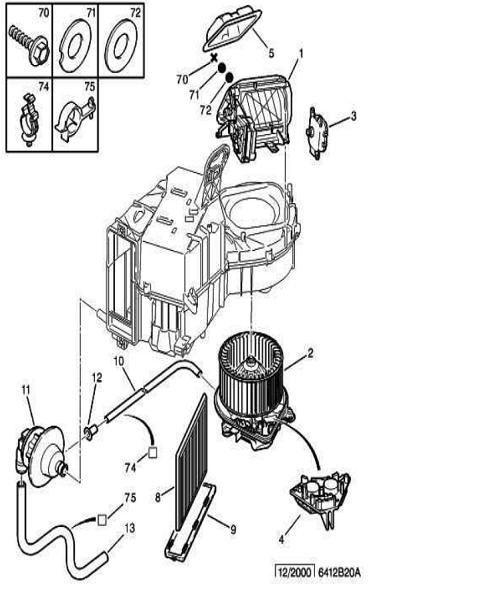

The part is 6441N4
No longer available from Citroen, but plenty of aftermarket ones available. Just make sure you confirm any replacement comes with the blower resistor module though!

Pulled down the carpet in footwell to have a good look at what I was going to attempt and took the pic I posted here. Didn't touch anything. Got into car yesterday started up and the fan now works as normal!

It might be that the bearings are seizing due to moisture in the motor and not enough welly to kick start the motor when it starts off at slow speed. The atmospheric conditions / temperature may have helped it on this occasion. I would keep an eye on it, but if it starts happening more frequently you may need to intervene.
