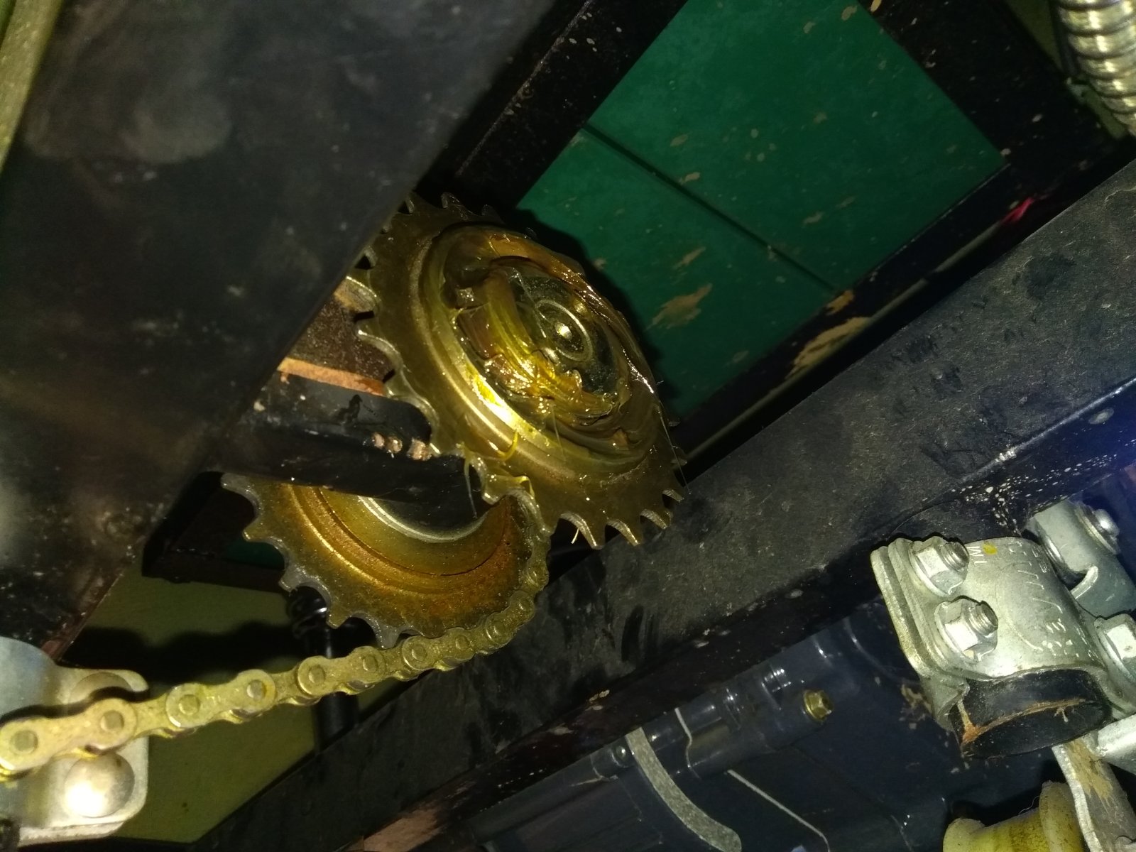

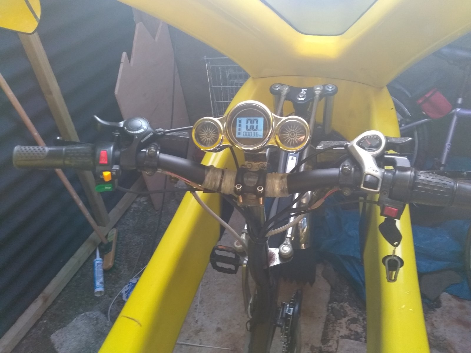

Had an Interesting repair job on today, lox Al lady with a 'special trike' she needed a sprocket and chain fix on! Link for image of one in use (Italians like them apparently,) motor throttle assisted pedal rickshaw affair!
https://images.app.goo.gl/yTVg5ntHNJtqD8Kj8
The owner found out when reversing if you back pedal you unthread one of the sprockets, all be it slowly, then all of a sudden you loose all drive.... Chap she purchased it from kindly sent down a spair Pair of sprockets, he had obviously tried to remove them, discovered how hard it was and simply cut them from the chassis!
Should have been a simple job of unthread one from the spare and pop it on!.....
anyways, few images from underneath for you, - first bike job I have done that needed the trolley jack and axle stands!!
Sprocket rebuild in situ

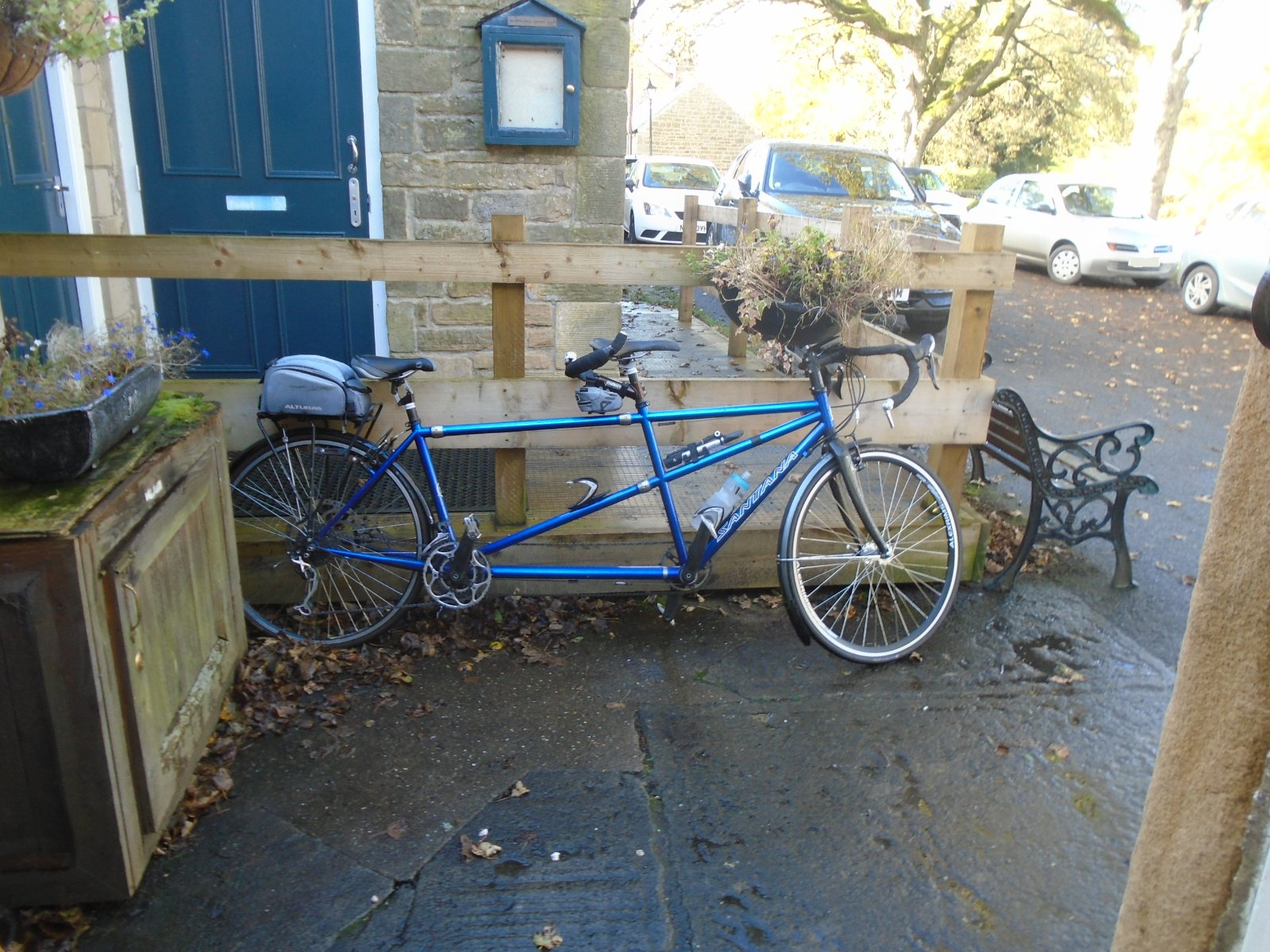

I always like to see a tandem. No idea if this is a good bad or indifferent one but It does have Santana on the frame which gets a few points from me seeing as Carlos is one of my favourites and a regular appearer on the Pickled Egg Jukebox. Here's a link to "Song of the Wind" for free. https://www.frenchcarforum.co.uk/forum/ ... na#p608501.

Is always nice to see a tandem out and about, couple in the local club, lovely pair, regular tandem tours when he hasn't injured himself on the mtb! 🤪 They have just done roscoff to santander tour on their one, many vineyards visited...... Would love the idea with the good lady, but sadly, I fear she is likely to be the one with her feet up out back! 🤪
