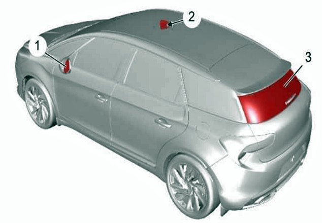

As for the demisting - I'm not sure what you are referring to - there is only one rear windscreen - at (3) on the diagram. If you are referring to the 2 rear quarter light panels (to the left and right of the rear windscreen, then no, they are not heated.

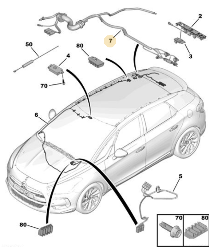

That will be it Paul - it's quite a hefty loom - item (7) and attached to the upper panel:

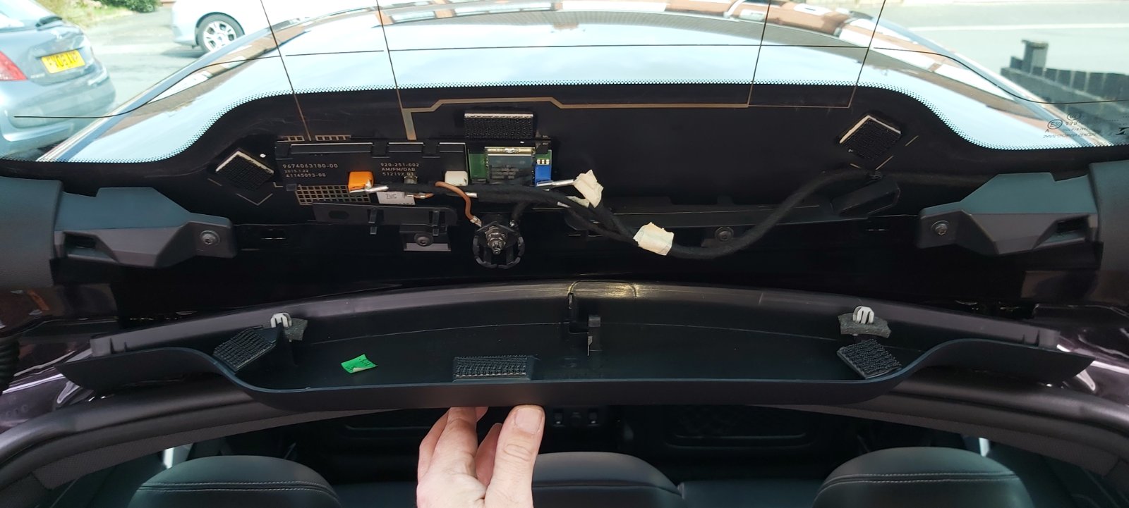

I know it's an old post but just for info, attached is a pic of the trim removed showing the radio antenna connections.
I was doing something else and remembered this post so thought I'd put this on

Orange for DAB, white for FM/AM and blue for GPS?
