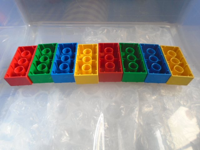

I found these with their little compartments and colour coding a great help in dismantling the laptop as reported on POTD.
Great for the fiddly multitude of little screws. Used them in conjuction with a larger plastic storage box for the bigger components.

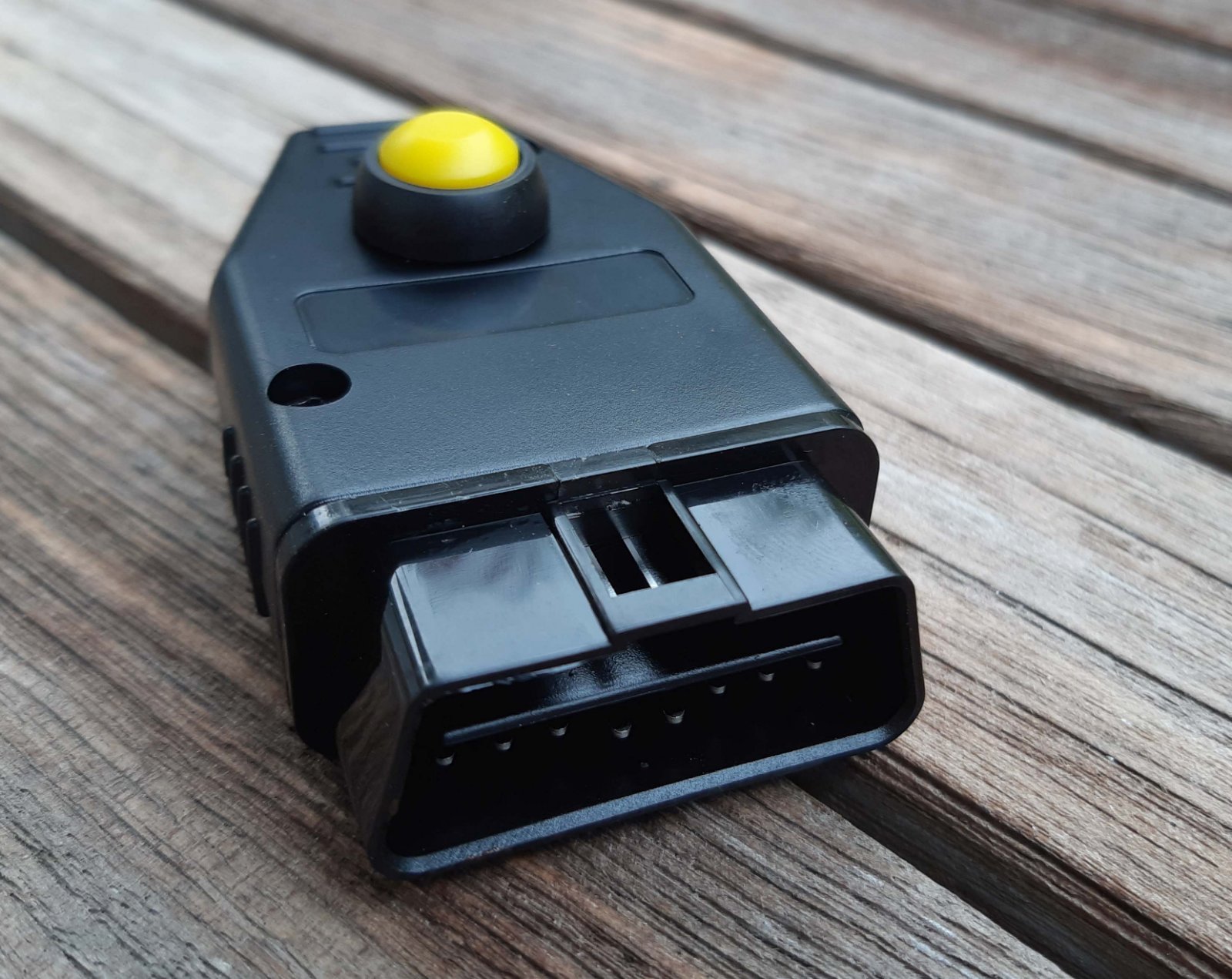

An OBD plug with a button on it ! Hi-tech stuff
Why have you put a yellow button on an OBD plug ? I hear no one ask.......
Ford Rangers and Mazda BT-50 of a certain vintage should have their MAF sensors put into a learning cycle at each service.... though it's often forgotten about
You can no doubt use the 'MAF learn' function on your very flashy OBD diagnostics kit...... or you can spend £5.46 on a button and an OBD plug and then wire pin 8 and one of the earth pins through the button. Once the engine is up to temp, press the button 5 times within 5 seconds and the truck goes into its 'learn' function and procedes to do two cycles of revving up to various RPM. Hey-garlic, basil and pine nut dressing - a bargain basement piece of hi-tech electronics. Or not.
