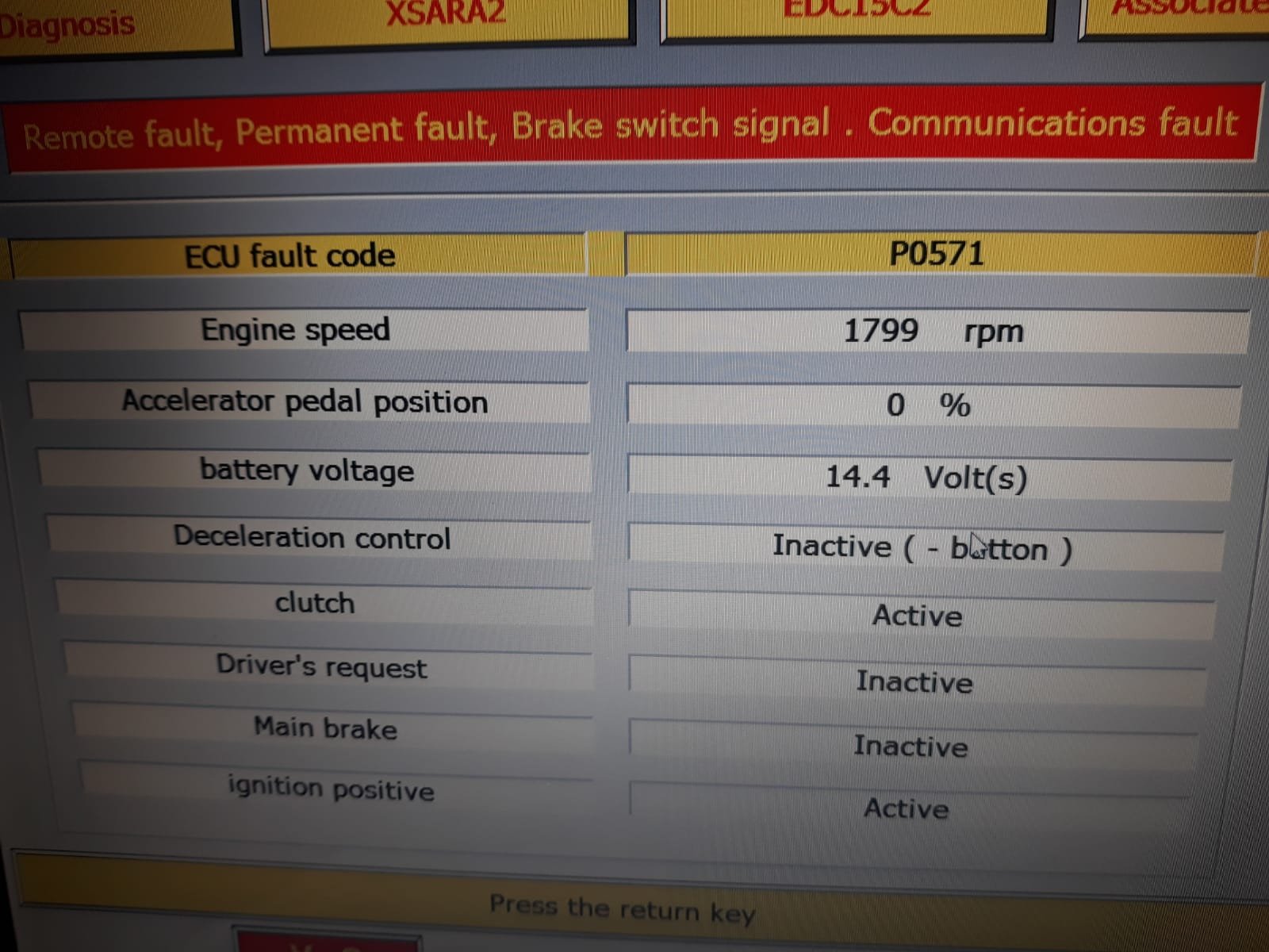

P1138
P0571
P0110
Got some others which did not return a code. Good only knows how is some of them are. I could not see a timestamp.
The pressure regulator was only changed a few months ago, so I hope that is not a new fault.
I'm not sure which of these faults caused it to go into limp mode a few weeks ago. All faults are still in the system. None have been cleared down yet.

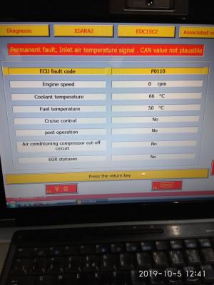

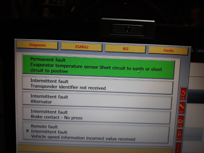

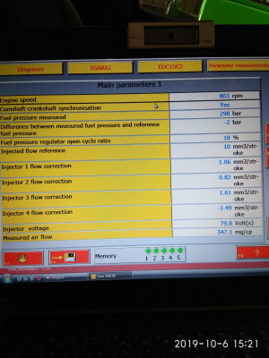

Okay so I've now run the tests again and I've now only got one coded fault and a bsi fault.
P0110
Permanent fault, inlet air temperature signal. CAN value not plausible.
Note that the values presented are now different to that in in the previous post above from Sunday.
Non coded bsi fault
Evaporator temperature sensor sorry circuit to earth or short circuit to positive.
Note that this car has no air con.
Any suggestions? Looks like a new MAF is required.
P0110
Non coded bsi fault

When I cleared down the BSI faults it redeclared two faults which were specific to the previous ECU.
Why would it still be holding on to them after clearing them down twice?
Specifically related to the brake switch fault P0571 was that more likely to be a ghost fault due to another issue or an intermittent fault with the brake switch itself (i.e. brake switch is on its way out).

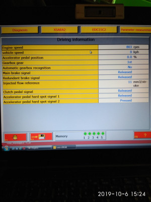

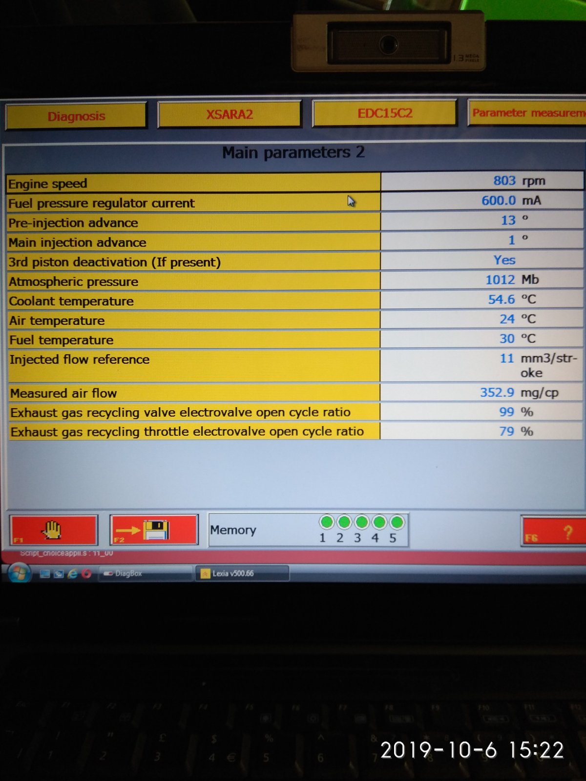

Fault P0110 still there. Old faults relating to a previous ECU are still being declared desipte being deleted numerous times. When I delete them and rescan they dissapear. However, when I subsequently open a fresh session they are back again.
The displayed outside temp on the in-car display seems correct - I assume that it comes from the same source. I didn't see anything in the side mirrors when removing the covers.
Is there a problem with the injector 4 flow correction value - seems out of step with the others.
