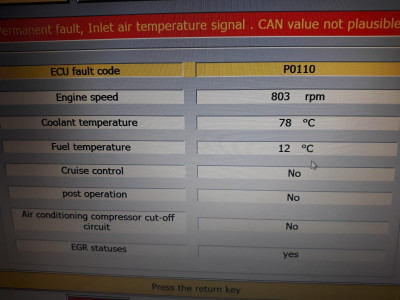

Okay so I've now run the tests again and I've now only got one coded fault and a bsi fault.
P0110
Permanent fault, inlet air temperature signal. CAN value not plausible.
Note that the values presented are now different to that in in the previous post above from Sunday.
Non coded bsi fault
Evaporator temperature sensor sorry circuit to earth or short circuit to positive.
Note that this car has no air con.
Any suggestions? Looks like a new MAF is required.

When I cleared down the BSI faults it redeclared two faults which were specific to the previous ECU.
Why would it still be holding on to them after clearing them down twice?
Specifically related to the brake switch fault P0571 was that more likely to be a ghost fault due to another issue or an intermittent fault with the brake switch itself (i.e. brake switch is on its way out).
The MAF was replaced a few years ago by Citroen dealer and I believe that it is a combined IAT/MAF component. A bit crap this it is FUBAR already given the price of it. With this fault do I need to validate the wiring on the from the connector back to wherever it goes (I assume into the ECU)?
Is there a way to verify the operation of the IAT using a multimeter?

I've cleaned it using proper MAF cleaner yesterday and took it out for a drive. Will try it on the diagnostics later and report back.

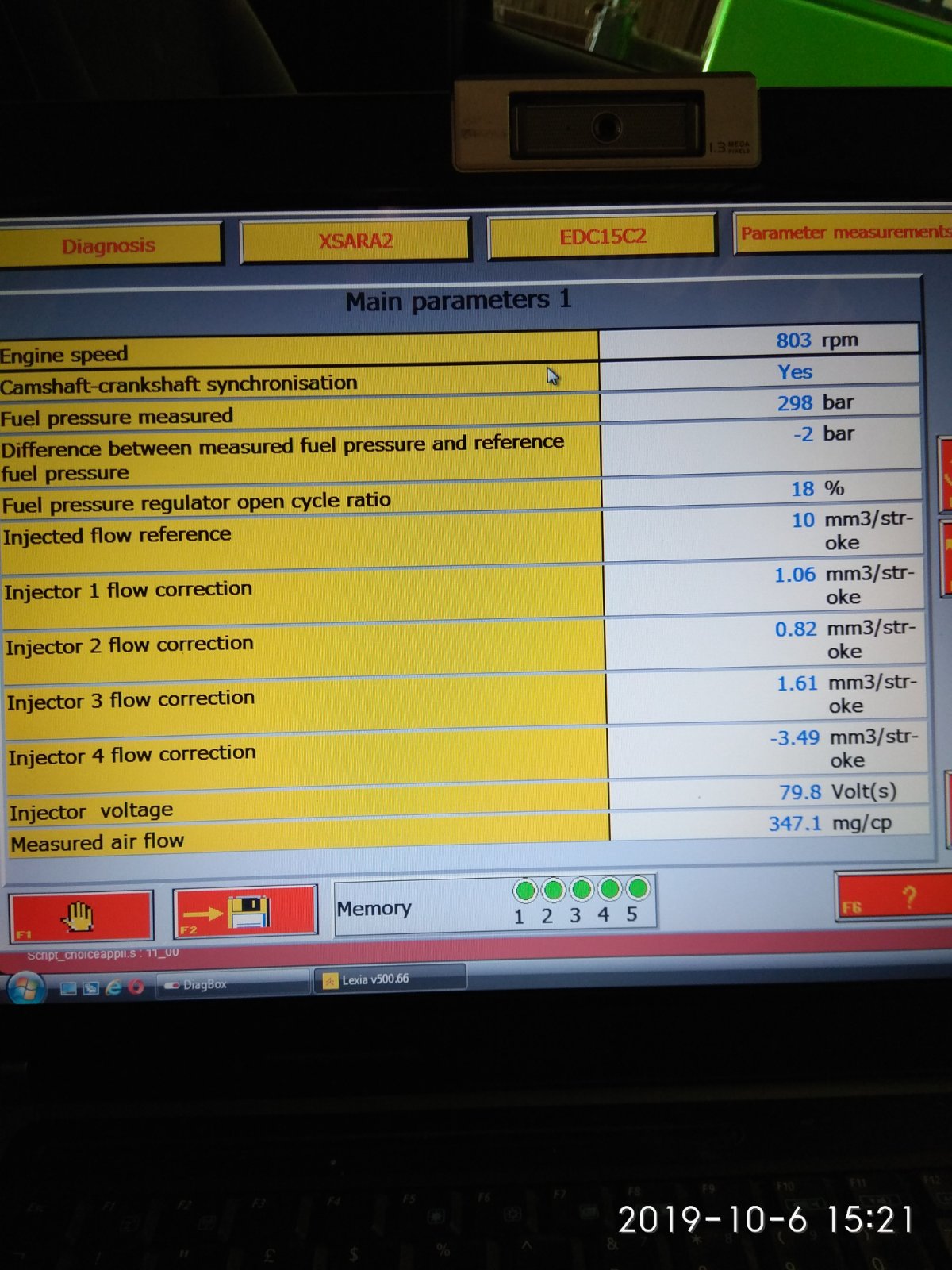

Fault P0110 still there. Old faults relating to a previous ECU are still being declared desipte being deleted numerous times. When I delete them and rescan they dissapear. However, when I subsequently open a fresh session they are back again.
The displayed outside temp on the in-car display seems correct - I assume that it comes from the same source. I didn't see anything in the side mirrors when removing the covers.
Is there a problem with the injector 4 flow correction value - seems out of step with the others.
