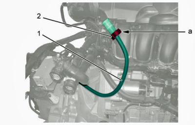

Ok so the known issue on the AL4 gearbox for the issue of any delay and shock in engaging first gear, or from going from first to second gear can be after driving on a flooded road.
The cause can be ingress of water in to the AL4 box after driving in 7cm of water over 60M and at speeds of between 6 MPH to 50 MPH.
The action required is to drain the AL4 gearbox and replacement of the oil filler breather.
You'll need a Breather (part 226822)
A Clip pack (part 1319L8)
Drain cap seals
Gearbox Oil
Preliminary checks to undertake: Check to see if there is any presence of a white deposit or for any water at the hydraulic distributor or on the cover.
If there is either - proceed with the repair - if not, the repair is not needed.
Procedure for repair:
Drain as much water from the gearbox as possible:
Drive the vehicle to heat up the oil in the gearbox to 100 °C by manually changing through all the gears at good engine speeds.
Drain the AL4 Gearbox
Fill the AL4 Gearbox
The oil in the gearbox must be at 60 °C in order to check the level correctly
Check the level of oil in the gearbox and top up if necessary - repeat the operation 2 times
Note that 3 drainings are necessary to drain the maximum amount of water.
Remove:
Check the operation of the automatic gearbox.
Drain cap seals
Gearbox Oil
Remove:
- The front left-hand wheel
- The front left-hand mud guard
- The air cleaner
- The ancillaries battery (BSI Reset / Battery Disconnect / Reconnect Procedure)
- The ancillaries battery support
| Fit the new oil filler breather (1). Secure the new oil filler breather (1) ( at "a") using the clip (2). Refit:
