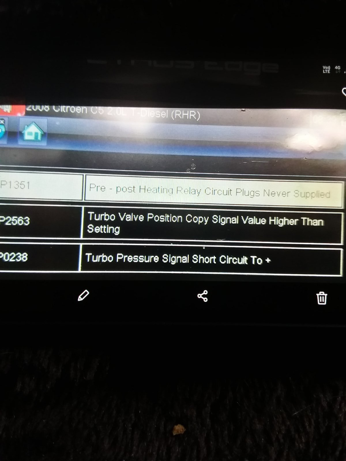

Afternoon all,
Finally got the codes today which are:
P1351
P2563
P0238
Any guidance appreciated
Bob
P1351
P2563
P0238
Bob

- x 6955
Re: Citroen C5 Juddery Acceleration at 2000rpm
Ok, so:
P1351 is a common fault - and means the pre-heating circuit relay is supplied, but the plugs are not. The preheating control unit indicates that the relay is open despite being commanded to close by the ECU for 5 seconds.
You may note the following symptoms: Lack of power, jerking, stalling, starting problem.
Suspect: Glow plugs, harness or the pre/post heating relay. However I have had this on mine since I've had it without issue.
P2563
This means there is a turbo position copy signal fault (positive difference). The measured position is above the reference value by 20% - so too much turbo pressure.
This will occur when the engine speed is above 1500 RPM and with an engine torque higher than 120Nm.
Downgrade Mode: When the fault is active, there will be inhibition of flowmeter plausibility faults, Torque limitation for the traction control and you cannot undertake a forced regeneration of the particle filter using a diagnostic tool.
Symptoms: Lack of power, Noise, Smoke from the exhaust.
Suspect: Turbocharger position copy sensor, Electrical harness, Connector, Vacuum problem, the variable geometry of the turbocharger is locked, Particle filter, Air metering valve.
P0238
Turbo Pressure Signal - short circuit to positive. This means the voltage of the turbo air pressure signal is higher than 4.8V (Turbo pressure greater than 2530 mbar) for 2.5 seconds or 125 engine revs.
Downgrade modes: Deactivation speed limiter until the next time the ignition is switched on, Deactivation cruise control until the next time the ignition is switched on, Cutting of the EGR valve: Fuel flow limitation, Deactivation of the regulation of the turbocharging.
Symptoms: Lack of Power, Slightly higher fuel consumption, Noise.
Suspect: Turbocharging pressure sensor, Turbocharger position copy sensor, Turbocharger blocked in position: Maximum turbo, turbocharger: Damaged, Turbocharging pressure sensor.
So there's the codes and explanations for a few pointers. I would start with the Turbo issues and leave the glowplug one for now.

- Posts: 10917
- Joined: 09 Nov 2005, 22:03
- x 1438
I am not an expert on these engines, but this fault code jumps out as being significant:
If there are no better ideas I would start by replacing that sensor.
Either that sensor is giving a bad reading, or the actual boost pressure is extremely high.GiveMeABreak wrote: 28 Sep 2019, 16:51 P0238
