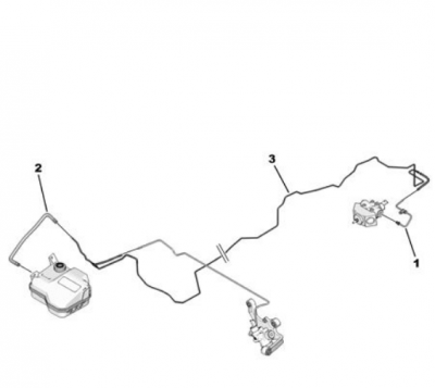

Here's the parts diagram:
And the prices (in GBP), neither particularly cheap!!
I don't know what sort of flare Citroen use on these pipes, if you get it off, then you might be able to get someone to make up a pipe if it is a 'std' flare.
As to replacing it, if it is over the tank, then I fear the tank will have to come out.... The long pipe 1 will be a mare to replace without a 4 post lift I imagine.

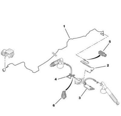

It will depend on whether this is the Supply or Return Piping...
Here are both diagrams:
Supply Piping RearReturn piping Rear

If it was going up, and it poured out, the odds on it's the supply pipe. There's no procedure, but the book time for item 1 appears to be over 6 hours..... :twisted:
