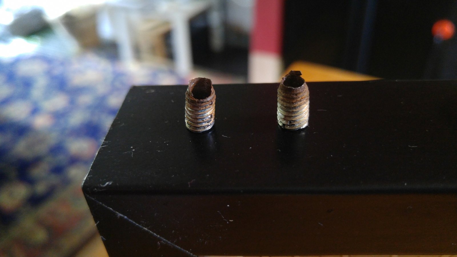

Well, I promised the results of my labours and here they are:
And, the extractor didn't break off stuck in the hole!
I discovered that the back of the screw hole is open to the elements - so, I stuck a knob of grease in the back of each to plug it up.

Might I suggest (if I haven't already done so) that you use copper slip grease on the new bolts. It won't dry out from the heat of the brakes, as it is good for over 1,000 degrees Celsius.

Bugger, forgot the copper slip - have to wait until they're next off
